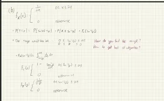

Given $X\sim\text{Unif}(0,2\pi)$, find the probability density function of the derived RV $Y = \sin(X)$.
I attempted the equation as follows however I am confused how to get the range of the PDF as well as the integration limit.
My attempt is herehere

Solution 1. The range of $Y=\sin X$ with $X\in[0,2\pi]$ is $[-1,1]$ not $[0,0]$ because $\sin$ is not monotone. You can draw the graph of $\sin$ with $X\in[0,2\pi]$ to see the range.
For $y\in[0,1]$, $$Y=\sin X\leq y\iff 0\leq X\leq\arcsin y\quad\text{or}\quad\pi-\arcsin y\leq X\leq 2\pi.$$ Thus, \begin{align*} F_Y(y)&=P(Y\leq y)=P(0\leq X\leq\arcsin y)+P(\pi-\arcsin y\leq X\leq 2\pi) \\ &=\frac{\arcsin y}{2\pi}+\frac{\pi+\arcsin y}{2\pi}=\frac{1}{2}+\frac{\arcsin y}{\pi}. \end{align*} For $y\in[-1,0)$, $$Y=\sin X\leq y\iff\pi-\arcsin y\leq x\leq 2\pi+\arcsin y.$$ Thus. \begin{align*} F_Y(y)&=P(Y\leq y)=P(\pi-\arcsin y\leq x\leq 2\pi+\arcsin y) \\ &=\frac{\pi+2\arcsin y}{2\pi}=\frac{1}{2}+\frac{\arcsin y}{\pi}. \end{align*} Therefore, $$F_Y(y)=\begin{cases} 1, & y>1; \\ \displaystyle\frac{1}{2}+\frac{\arcsin y}{\pi}, & y\in[-1,1]; \\ 0, & y<-1. \end{cases}$$ Consequently, $$f_Y(y)=\begin{cases} 1/(\pi\sqrt{1-y^2}), & y\in[-1,1]; \\ 0, & \text{Otherwise}. \end{cases}$$

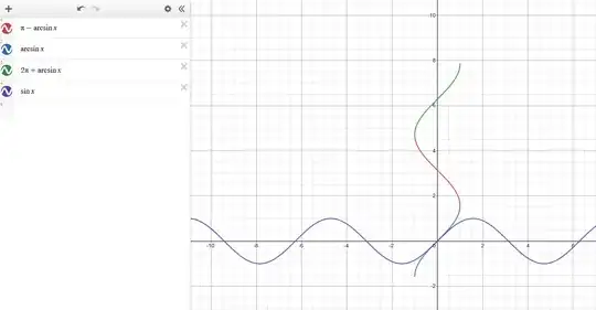

The following picture illustrates how I obtained the inverse function:

  • how did u get π−arcsiny ≤ X ≤2 π. – Jeffrey Anders Apr 06 '21 at 16:53
  • @JeffreyAnders Please see the picture attached in my answer. – Bernard Pan Apr 06 '21 at 17:23
  • Im sorry but im still not getting the logic behind it.. – Jeffrey Anders Apr 06 '21 at 17:34
    I take $y\in[0,1]$ for example. Imagine you draw a horizontal line with $y$-intercept $y$. It will naturally intersect the graph at two points, which are symmetric about $\pi/2$. In particular, by the definition of $\arcsin$, the $x$-coordinate of the left point is $\arcsin y$, so the $x$-coordinate of the right point is $\pi-\arcsin y$. By the graph, we can see that $Y=\sin X\leq y$ implies $0\leq X\leq\arcsin y$ and $\pi-\arcsin y\leq X\leq 2\pi$. The analysis is the same for $y\in[-1,0]$. – Bernard Pan Apr 06 '21 at 18:19
