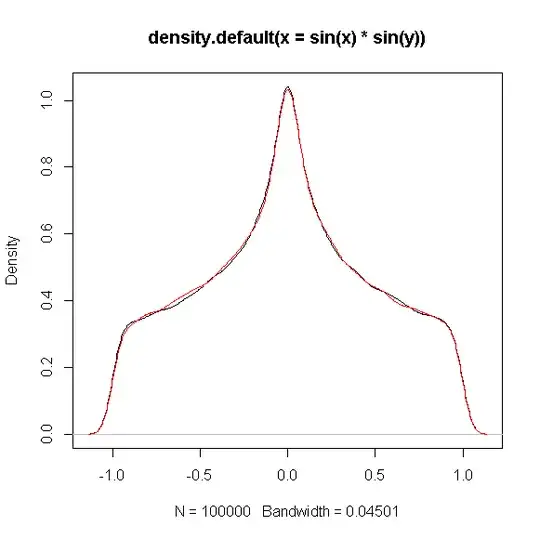

 R code
 n<-100000
 x<-runif(n,-pi,pi)
 y<-runif(n,-pi,pi)
 plot(density(sin(x)*sin(y)))
 lines(density(.5*(sin(x)-cos(y))),col=2)
density1

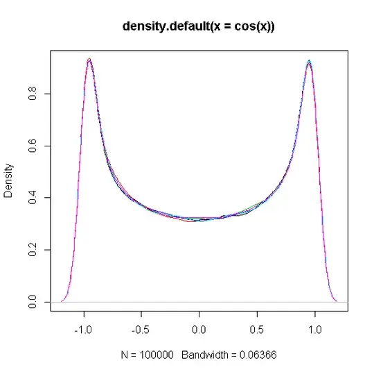

If $U$ and $V$ are uniform so all of the following random variables have same distribution
$\cos(U)$,$\cos(2U)$,$\sin(U)$,$\sin(2U)$,$\cos(U+V)$,$\cos(U-V)$,$-\cos(U)$
       R code
       n<-100000
       x<-runif(n,-pi,pi)
       y<-runif(n,-pi,pi)
       plot(density(cos(x)))
       lines(density(sin(y)),col=2)
       lines(density(sin(2*x)),col=3)
       lines(density(cos(2*x)),col=4)
       lines(density(cos(x+y)),col=5)
       lines(density(sin(x+y)),col=6)
