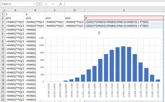

Quick edit for clarity: I did run a numerical simulation with $A=1$ and $B=0$ in Excel as a sanity check that the mode would occur around the middle. For a single $\phi_1$, yes the mode is at the tail but the joint distribution's mode is were I expect it to be. Excel Simulation
