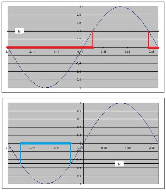

To help to calculate the probability $$P(\sin(\pi \theta)\leq u)$$ take a look at the following figure: enter image description here
In the upper figure, $u>0$ and if $\pi\theta$ falls in the thick red region then the event in question occurs. That is, for $1\geq u>0$ the probability (the value of the cdf) at $u$ is
$$\frac{\pi+2\sin^{-1}(u)}{2\pi}=\frac12+\frac{\sin^{-1}(u)}{\pi}.$$
In the lower figure, one can see when the event in question takes place; look at the thick blue line. So the probability (the value of the cdf) for $-1\leq u\leq0$ is
$$\frac{\pi-2|\sin^{-1}(u)|}{2\pi}=\frac12-\frac{|\sin^{-1}(u)|}{\pi}.$$
