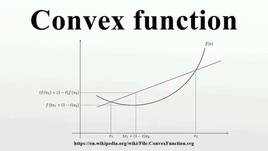

  • The function must be convex function. What is convex function?
If the line segment between any two points on the graph of the function lies above or on the graph then it is convex function.
example is given below:

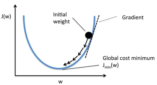

  • Less Learning rate(alpha), which means the step size The alpha must be less and must change according the gradient. enter image description here
If the alpha is high the step oscillates and global minimum is not guaranteed.
