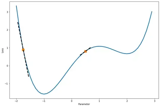

The following example illustrates this. Given a loss function (blue) over a single parameter (x-Axis), we see two points of interest. While the left is closer to the minimum (on the x-Axis / in the parameter space), it is also the point with the steeper gradient (black).
Example with one Parameter
