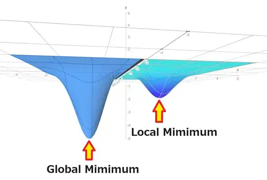

<Global and Local Minima>
  • A global minimum is the globally minimal point whose gradient is zero but not a local minimum.
  • A local minimum is the locally minimal point whose gradient is zero but not a global minimum.

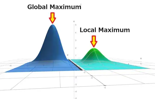

<Global and Local Maxima>
  • A global maximum is the globally maximal point whose gradient is zero but not a local maximum.
  • A local maximum is the locally maximal point whose gradient is zero but not a global maximum.

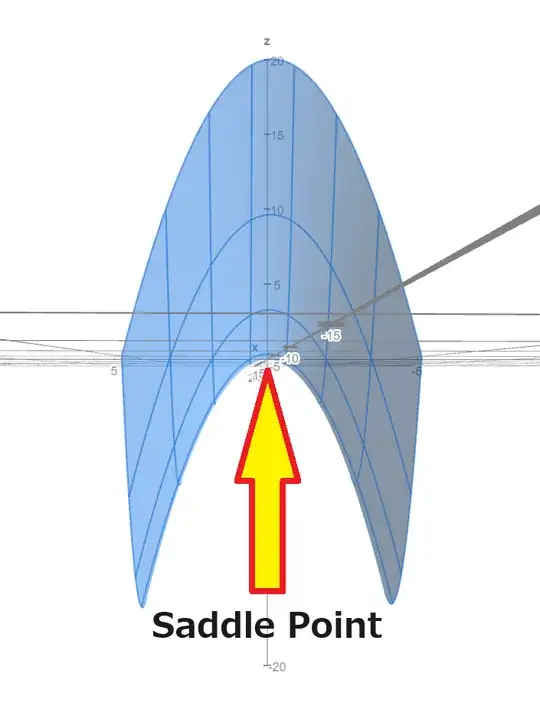

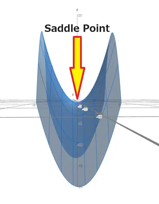

<Saddle Points>
A saddle point is the combination point of a local minimum and maximum.
