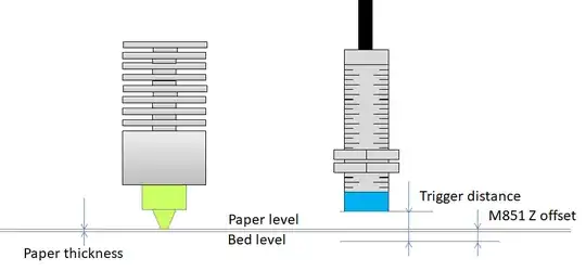

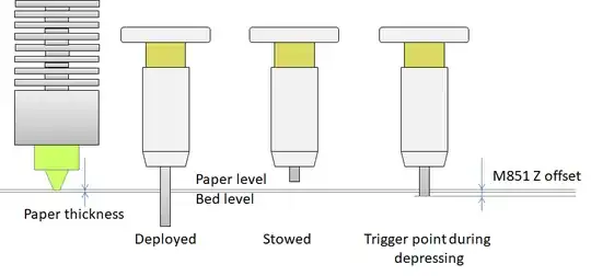

Note that this scanning of the surface is generally done at a distance from the actual nozzle (except for pressure sensor systems where the nozzle is used as the probe), the images below show this for a BLTouch sensor and an inductive/capacitive sensor. For an inductive sensor this is the distance of detecting metal (minus the distance to the nozzle), for a BLTouch this is based on the triggering point of the extendable probe, see this answer (the image below depict the terminology). The operator of the printer needs to determine at which distance this bed has been scanned. This is commonly known as determining the Z-offset. The Z-offset can be set using a terminal or through the display. Setting this Z-offset is described in detail in "Specifying Z offset in Marlin firmware".
Once the shape of the bed is captured (G-code command G29) and stored and the correct distance (Z-offset) set with M851 Zx.xx (or through the display), the use of the shape needs to be activated in the starting G-code section of the G-code file of the print.
The nozzle will now be following the bed shape to improve the bed adhesion, this compensation is by default set to be smeared out in 10 mm, but can be disabled or changed to any other value using M420 Zxx. The nozzle will print in the X-Y plane without compensation after the compensation distance. If you do not tram the bed correctly, the bottom of that print object will thus not be square to the height! See question "Does auto leveling result in sheared prints?".
BLTouch or 3DTouch sensor Z-offset definition
Inductive/capacitive proximity sensor Z-offset definition
