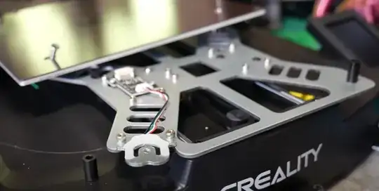

The Creality Ender 3 V3 SE, apart from auto bed leveling (ABL), also has a way to calculate the Z-offset automatically. A feature I didn't hear about before.
According to a Maker's Muse video, it's based on a force sensor as shown below.
'Force Sensor' in Creality Ender 3 V3 SE
How does this concept work? How can a force sensor automatically determine the Z-offset?

This implies that the strain gauge is not used to determine the level of the bed, instead the surface of the build plate is scanned/mapped by the CR Touch (BLTouch clone) sensor. In order to map this scanned surface to the correct height, a test point with the nozzle hitting the buildplate (and as such causing the strain gauge to measure that the nozzle touches the surface) is used to set the Z-offset based on this measurement. Without such a strain gauge, the printer user needs to do that manually; this is the process where you set the offset using the M851 G-code command. Instead of the user lowering the nozzle until a piece of paper can be dragged with a little resistance to determine the "true zero position" of the Z-axis, the triggering of the strain gauge and the automatic handling by the Creality software will do that for you.

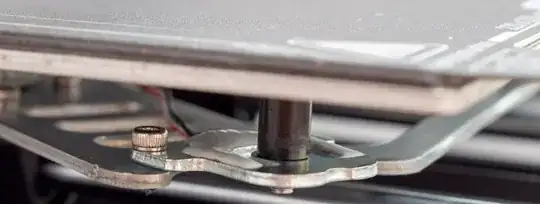

To explain the automatic calculation of the Z-offset in this printer is that the Creality Ender 3 V3 SE first calibrates the Z-offset with the help of a pressure of strain-gauge sensor mounted under the front left corner of the print bed, there is a strain-gauge sensor which can detects deformation on the structure that is mounted on.
Knowing the exact position of the nozzle and the position (height) of the trigger point of the leveling sensor, the Z-offset can be calculated and set. That height is then put into the M851 G-code command to set the Z-offset. This is exactly how you would do this manually other than you usually use a sheet of paper or a feeler gauge between the nozzle and the bed. The automatic calculation will surely make a correction for that (e.g. there could be play in the nozzle assembly).

The Z offset is just the height difference between tip of the probe pin and the tip of the nozzle.
The auto Z offset feature on the V3 SE works by lowering the toolhead until the tip of the leveling or tramming probe touches the bed surface it then takes that measurement and store it, then it lowers he tool head further until the tip of the nozzle makes contact with the bed, the strain gauge which is the same type of sensor used in a digital scale detects the pressure of the nozzle tip touching the bed however many steps the Z stepper motor had to make after lowering the tool head for the probe tip to touch the bed is the Z offset. Z offset just tells the printer what absolute 0 position is of the Z axis, the level probe probes the bed to check for inconsistencies in the build plate surface
