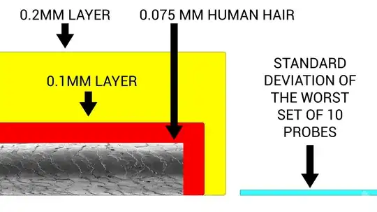

I found Teaching Tech's comparison of probes quite thorough and informative: Six popular ABL probes compared: Accuracy, price, wiring and more! - YouTube
My take away was that all the ones he tested were more accurate than a hobbyist 3D printer needs, so it really comes down to convenience: which is the easier / cheaper option for your situation. He has this great infographic in his video's conclusion:
Infographic showing that the standard deviation of the tested probes is about a tenth the width of a human hair, which is itself about a third the width of a typical first layer height
He also published a Google Doc with his results: TT testing - Google Sheets
