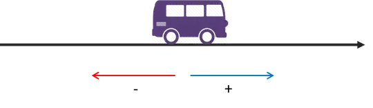

Let's imagine we're sitting near a road, and there is a car that is moving with a constant speed. We also have a clock, and so we can measure time.
Before going any further, we should first specify some assumptions like if the car is moving in the right, then its velocity will be positive, and if it's moving in the left direction, then its velocity will be negative.
Imagine now that you have a video of the above scene, and time is positive if you play the video normally but is negative if you play it backwards. We also know the following: $$\rm Velocity=\dfrac{\rm Distance}{\rm Time}.$$ Solving for distance we get: $$\rm Velocity\times{\rm Time}={\rm Distance}.$$ Here the important part comes, if the car is moving in the $+$ direction and the time the video is played is positive, i.e. the video is played normally, then you'll see that the car moves along the $+$ direction and you'll calculate that it moves "a positive distance". Therefore the following holds: $$\rm positive\times positive=positive.$$
If the car moves along the $-$ direction and the time the video is played is positive, i.e. the video is played normally, then you'll see the car going along the $-$ direction, you'll then calculate that it moves "a negative distance". Thus: $$\rm negative\times positive=negative.$$
If however, the car moves along the $+$ direction but the time the video is played is negative, i.e. the video is played backwards, then you'll see that the car is moving in the $-$ direction, and you'll calculate that it moves "a negative distance". Thus: $$\rm positive\times negative=negative.$$
If the car moves along the $-$ direction but the time the video is played is negative, i.e. the video is played backwards, you'll see that the car moves along the $+$ direction! Thus it moves "a positive distance". And therefore: $$\color{grey}{\boxed{\color{white}{\underline{\overline{\color{black}{\displaystyle\rm\, negative\times negative=positive.\,}}}}}}$$ As you have seen, it takes only a little bit of imagination for it to make sense.
I hope this helps.
Best wishes, $\mathcal H$akim.

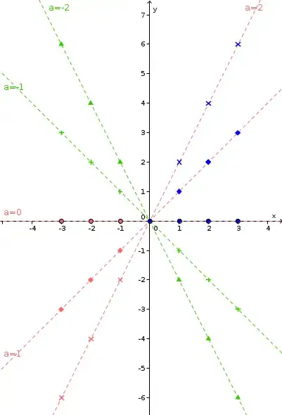

This is a sketch of an explanation that can easily be made more or less formal.
My job now is to explain to you (who have a clue) my way to explain to somebody else (who has almost no clue). That's why I use formal language (like define) and notation (like $f(x)$) in order to keep my answer neat. At the same time I stick to integers, as if this "somebody else" was a kid. Adjust the form and scope to your interlocutor's level.
Let's define
$$ f_a(x) \equiv ax$$
The explanation goes as follows:
  1. On $XY$ plane plot $y=f_0(x), \space y=f_1(x), \space y=f_2(x), \space … \space$ for $x \in \{0,1,2,3,…\}$; use different symbols/colors to distinguish the functions.
  2. Notice (or better let the interlocutor notice) that the points of $f_0$ lay along a straight line, the points of $f_1$ lay along another straight line etc.
  3. There is no reason this rule shouldn't apply when we consider $x \in \{…,-2,-1,0,1,2,…\}$; expand the plot.
  4. Notice $\forall a \space f_a(0)=0$. Why?
  5. Notice $\forall a \space f_a(1)=a$. Why?
  6. There is no reason the three rules shouldn't apply for negative $a$; plot $y=f_{-1}(x), \space y=f_{-2}(x), \space … \space$ according to the rules.
It will look like this:
plot
Only the blue points were obtained by actual multiplication. The rest of them were placed thanks to the rules found.
And here you go. The result of $(-1) \cdot (-1)$ is there among few others.
You can replace "there is no reason the rules shouldn't apply" with some formal proofs if your interlocutor can understand them. While explaining to a kid it should be enough to point out this is the way mathematics works – coherence, no unnecessary exceptions, rules as broad as possible. I think it can be quite reassuring on an early stage of education.

sjets3 14.1k points 7 months ago
Imagine you are watching a movie. The first number is how the person in the movie is moving. The second number is how you are watching the film (normal or in reverse).
$1 \times 1$ is a person walking forward, you watch it normal. Answer is you see a person walking forward, which is 1.
$1 \times -1$ is a person walking forward, you watch it in reverse. You see a person walking backwards. -1
$-1 \times 1$ is a person walking backward, you watch it normal. You see a person walking backwards. -1
$-1 \times -1$ is a person walking backwards, but you watch it in reverse. What you will see is a person that looks like they are walking forward. 1
As a funny example of the last para. overhead, compare https://gfycat.com/PopularFrighteningCormorant (original video) with https://i.imgur.com/ZCw2C81.gifv (film person walking backward then play backward).
