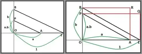

But Descartes took the product of two lines to be another line. [emphasis is mine] That required selecting a unit line, that is, a line of length $1$. Then to find the product $ab$ of two quantities $a$ and $b$, he only needed to find the fourth proportional of $1$, $a$, and $b$.
Here is the construction by Descartes (figure on the left):
After defining a unit OE and the lengths (= reals) OA and OB, in order to define the product OP, it is necessary to draw a line OP parallel to EB.
Of course, there is a relationship between Euclid's and Descartes' construction: the areas of OARB and OEQP are equal.

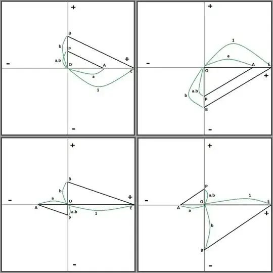

Why is negative times negative = positive?
Descartes' Euclidean Geometrical Algebra gives us a nice proof without words :
