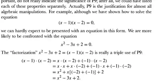

Hi, I have a basic question concerning definition of the word 'factorization'. Does Spivak consider factorization as development of factors ? He goes from saying the "factorization" $x^2-3x+2=(x-1)(x-2)$ is really a triple use of $P9$ and goes on showing development.
$P9$ says : If $a,b,$ and $c$ are any numbers, then : $a \cdot (b+c)= a \cdot b +a \cdot c$
Also, when Spivak does the following : $(x-1)(x-2)=x(x-2)+(-1)(x-2)$ does he use any property or just assumes it as like this ? I know whats happening, just curious if there's any justification to it.

    Yes, factorization means splitting into factors. For the second question, he is using P9 "backwards", where $a = x-2$ – Euler....IS_ALIVE Dec 24 '13 at 01:36
  • Then why doesn't he show how to factor it ?? Also, I though that the three use of P9 were when he expands the first two terms x(x-2)+(-1)(x-2) and when he uses it for x(-2)+(-1)x to add the two terms. –  Dec 24 '13 at 01:42
  • Spivak's goal isn't to show you how to factor polynomials (you should have learned that in algebra). He's trying to axiomatize your (previously learned) knowledge of algebra. The "3 uses" can be used either backwards (from ab + a+c to a(b+c) OR forwards (from a(b+c) to ab + a*c)... that's the symmetry of equality. – Tyler Dec 24 '13 at 03:02
  • You listed the first two uses of P9, the 3rd use is to go from x(-2) + (-1)x to x[(-2) + (-1)] – Tyler Dec 24 '13 at 03:09
I can see how a reader might easily be confused by the passage that you quoted. It seems that Spivak's goal here is to emphasize the fundamental role played by $\rm P9$ (the Distributive Law) by highlighting the key that it plays in even the simplest of arithmetical (ring-theoretic) calculations, such as factoring a quadratic polynomial, law of signs, etc. Because the distributive law is the only law that connects the additive structure to the multiplicative structure in a ring, it must be used in any proof of a theorem that is not purely additive, or purely multiplicative. Without the distributive law a ring degenerates to a set with two completely unrelated additive and multiplicative structures. So, in a sense, the distributive law is a keystone of the ring structure.
The proof that he gives of the "factorization" $x^2-3x+2 = (x-1)(x-2)$ is not meant to be read as the derivation (discovery) of the factorization but, rather, simply as a proof that this equation is true. The point is simply to illustrate the key role that $\rm P9$ plays in proving this equality.
Normally transforming the lhs to rhs, i.e $\,x^2-3x+2$ to $(x-1)(x-2),$ is called factorization, and the reverse direction is called expansion. Each necessarily involves multiple applications of the distributive law $\rm P9$ (in various directions). Probably the reason Spivak put scare quotes around the word "factorization" is because the equation could be read either way, as a factorization or an expansion. What makes matters more confusing is that his proof of the "factorization" equality actually goes from rhs to lhs, so it would normally by called an expansion of $\,(\color{#c00}{x-1})(x-2)\,$ by distributing the factor $\,x-2\,$ into the summands $\,\color{#c00}x\,$ and $\,\color{#c00}{-1},\,$ yielding
$$\begin{align} &(\color{#c00}{x}\ +\ (\color{#c00}{-1}))\, (x-2) \\[.4em] =\ & \color{#c00}x(\color{#0a0}{x-2}) + (\color{#c00}{-1})(x-2)\end{align}$$
then distribute $\,\color{#c00}x\,$ into the summands $\,\color{#0a0}x\,$ and $\,\color{#0a0}{-2},\,$ and similarly distribute $\color{#c00}{-1}$ yielding
$$x(\color{#0a0}{x}) + x(\color{#0a0}{-2}) + (-1)x + (-1)(-2)$$
Thus this complete expansion applied the distributive law four times in total.
In any case, don't let the unoriented terminology disorient you. You can safely ignore this, since Spivak's point is not to give a definition of factorization or expansion but, rather, to show prototypical applications of $\rm P9$.

  • That's exactly what I was wondering. The way he used the word "factorization" and showing the expansion got me confused. Thank you for the answer ! –  Dec 24 '13 at 16:12
