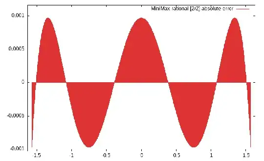

Absolute Error
If we want to minimize the absolute error, it's simpler to start with approximating $\cos$ for $|x|\leqslant \pi/2$. We start by approximating
$$ f(x) = \cos(\sqrt x) \quad \text{ with }\quad x\in[0,\pi^2/4] \tag 1$$ and then use $$ \cos x = f(x^2) \tag2 $$ That way, we get the symmetry of $\cos$ and $f$ can be approximated by a rational function $g$ of degree [1/1]. Doing the numerics (Remez algorithm), one finds
$$ g(x) = \frac{p(x)}{q(x)} = \frac{9.8473383 - 3.9958133 x}{9.8377958 + x} \tag 3 $$
where the function is normalized so that coefficient $q_1=1$. The coefficients of the numerator and denominator polynomial only loosely resemble the values of $\cos \approx(\pi^2-4x^2)/(\pi^2+x^2)$ worked out in the other answer.
The absolte error is given by
$$ \max_{x\in[0,\pi^2/4]} |g(x)-f(x)| = \max_{|x|\leqslant \pi/2} |g(x^2)-\cos(x)| < 0.00097 \tag 4$$ which is an accuracy of around 3 decimals or almost exactly 10 bits.
Plot: Absolute error of $g(x^2)$ against $\cos(x)$ for $|x|\leqslant\pi/2$.
Absolute error of g(x^2) against cos(x)

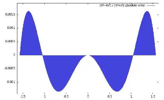

The optimality of $g(x)$ (or of $g(x^2)$ for that matter) follows from the alternant property of the absolute error: If $\Delta=\max|g-f|$ the absolute error oscillates between $+\Delta$ and $-\Delta$ which is nicely demonstrated by the plot above.
In contrast, the non-optimality of the classic
$$ \frac{\pi^2-4x^2}{\pi^2+x^2} \tag 5$$
is immediately clear from the plot below because the absolue error does not oscillate nicely with constant "amplitude".
Plot: Absolute error of $(π²−4x²)/(π²+x²)$ against $\cos(x)$ for $|x|\leqslant\pi/2$. Absolute error of classic (pi²-4x²) / (pi²+x²)
Conclusion
  • The classic $(\pi^2-4x^2)/(\pi^2+x^2)$ has an absolute error of ca. $1.63\cdot 10^{-3}$, whereas the optimal $$ g(x^2) = \frac{9.8473383 - 3.9958133 x^2}{9.8377958 + x^2} \tag6 $$ has an absolute error of less than $10^{-3}$.

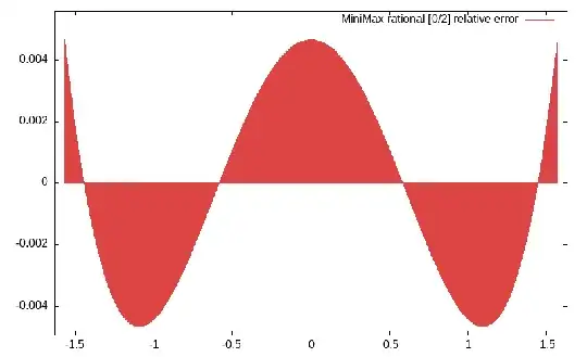

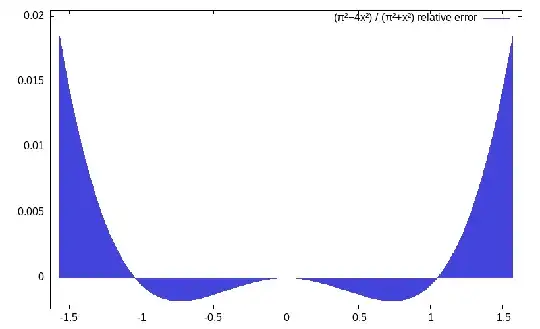

Relative Error
For optimizing the relative error, the situation is similar: The classic formula is sub-optimal, and we can numerically approch the best possible rational function of degree [2/2].
As $\cos$ has zeros at $\pm\pi/2$, we have to divide them out so that the relative error is well-behaved. Using Remez, we find:
$$ \frac{\cos x}{(\frac\pi2-x)(\frac\pi2+x)} \approx r(x)=\frac{3.676844}{9.030178 + x^2} \tag7 $$ with a relative error of $0.0047$ over the target interval as shown by the following plot.
Relative error of r(x)(pi/2-x)(pi/2+x) against cos(x)
Hence, the best approximation in terms of relative error amongst all rational functions of degree [2/2] or less is:
$$ r(x)\left(\frac{\pi^2}4-x^2\right) = \frac{3.676844}{9.030178 + x^2}\left(\frac{\pi^2}4-x^2\right) \tag8 $$
The relative error of the classic approximaton is around $0.019$, which is 4 times the relative error of $(8)$. Absolute error of classic (pi²-4x²) / (pi²+x²)
