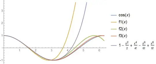

$$ f_1(x)=2\left(1-\frac{x^2}{2^{3}}\right)^2-1 $$
$$ f_2(x)=2\left(2\left(1-\frac{x^2}{2^{5}}\right)^2-1\right)^2-1 $$
$$ f_3(x)=2\left(2\left(2\left(1-\frac{x^2}{2^{7}}\right)^2-1\right)^2-1\right)^2-1 $$
For the angles in the range $0<x<\frac{\pi}{2}$ Taylor expansion of the same order fits better. On the other hand, for larger angles this method is superior, as you can see from the graphs.
cos(x), f1, f2, f3
So, is this method widely known? Can it be useful for calculating trig functions in some cases?

The computation of trig functions is usually done by reducing the argument to a relatively small range, such as $0 \le x \le \pi/4$.
Once this is done, there are many ways to compute the function (cordic, pade approximations, table lookup + interpolation, chebychev approximation, ...). Taylor series are not used because they are good at a single point and get worse away from that point.
Finally, if necessary, the result is mapped back to the original argument.
So, your approximations, while interesting, would probably not be used.
