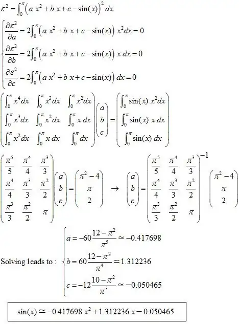

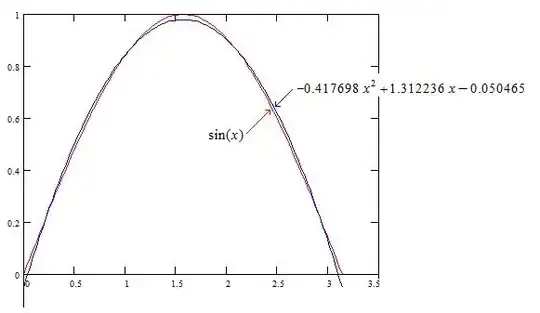

The answer has already been given.
In addition, the numerical solving and the graph are shown below, in order to compare the results.
Note that the result corresponds to the mean least square absolute deviation. A small modification of the method and formulas would give the result corresponding to the mean least square relative deviation, which could be more convenient in the low range of $\sin(x)$.
