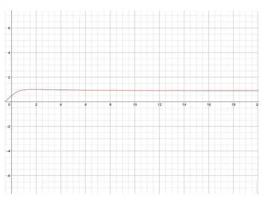

So how does $\frac{7k+4}{8\sqrt{k^2+1}}$ behave? Not that bad.
Here is a graph:
So as the graph shows, in the interval $(1,\infty)$ the best approximation occurs at $k=1$ for which we get $\frac{7+4}{8\sqrt{2}}=\frac{11}{2\sqrt2}\approx 0.972$. After this the ratio becomes smaller and smaller, the limit is $\frac{7}{8}=0.875$.

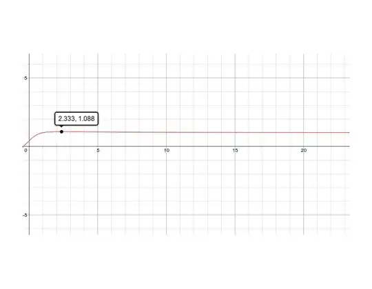

I didn't think a lot but taking $l=\frac{3}{7}$ seems to give a good result. Here is the graph of $\frac{k+3/7}{\sqrt{k^2+1}}$
This is a better approximation, the ratio of the correct measurement, versus the actual measurement when $k\geq 1$ reaches a maximum of approximately $1.088$ when $k=2.\overline 3$, this is the worst it gets, it improves when $k$ approaches $1$, reaching the minimum of $1.01$ and it also improves as $k$ goes to infinity, with a limit of $1$. (as an opposite of the first approximation this approximation always gives a hypotenuse longer than it actually is, which again tells us this is not actually the best approximation)

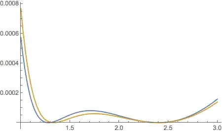

Numerical optimization reveals how truly astonishing the approximation is:
Taking a hint from @dREaM's answer and normalizing the length of the shortest side, for side lengths $1$ and $k$ we are interested in the ratio
$$\frac{ak+b}{\sqrt{k^2+1}}$$
as a function of the coefficients $a$ and $b$ (in the Tamil approximation, $a=7/8$ and $b=1/2$). We want the ratio to be as close to $1$ as possible for a large number of side lengths. Some experimentation shows that it is the region $k \in [1,3]$ that is the most problematic, so it makes sense to minimize the integral
$$ \int_1^3 \left(1- \frac{ak+b}{\sqrt{k^2+1}}\right)^2 \>dk $$
for $a,b$. Numerically, the minimum lies near
$$ \begin{align} a &= 0.871079 \\ b &= 0.509221 \end{align} $$
which is very close to the values given in the original text. In fact, plotting the integrand for the original (orange) versus the numerically obtained (blue) coefficients shows that the values are very near optimal in the range $[1,3]$, and most of the discrepancy happens where the side lengths are close to each other (that is, where $k$ is close to $1$):
Coefficients
If we assume that most practical right triangles have short sides that are within a factor of $3$ of each other, then given the very simple fractions used there can be no doubt that the original approximation is "optimal" in a practical sense.

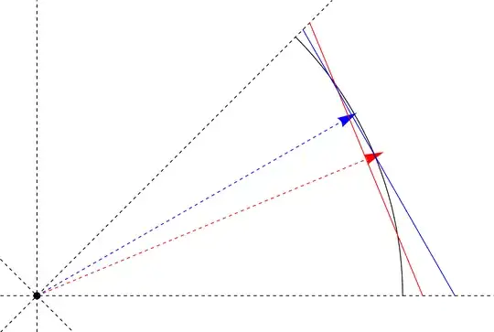

This is simply a linear approximation of the Euclidean distance function on one octant of the plane by measuring the length of a scaled projection to the vector
$$\binom{\frac{7}{8}}{\frac{1}{2}} .$$
This works because a circle doesn't look that different from a straight line when it's observed over a sufficiently small angle, such as a single octant.
The figure below tries to demonstrate this; the black arc is the unit circle inside the octant, blue line corresponds to points at the unit distance measured by this projection, and the dashed blue arrow is the vector above.
There are multiple criteria for these sort of approximations, but if we want to make the mean distance measure over all points in the octant match the Euclidean norm, the optimal vector is:
$$\frac{\pi}{8} \csc \left(\frac{\pi}{8}\right) \binom{\cos \left(\frac{\pi }{8}\right)}{\sin \left(\frac{\pi }{8}\right)} = \frac{\pi}{8} \binom{1+\sqrt{2}}{1}$$
... which corresponds with the red parts in the figure above. (Yes, I pulled this out of my Mathematica session.) These vectors are easier to compare as decimal approximations:
$$\binom{0.875}{0.5} vs. \binom{0.948059}{0.392699}$$
They're not that far off if you're using just multiplies of eighths and actually care about the situation also from the perspective of the length and the angle of the vector.

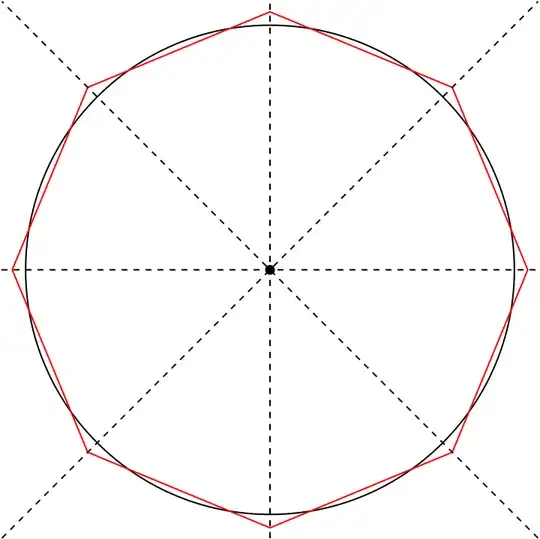

The "optimal" solution above also has a nice correspondence with a regular octagon overlapping the unit circle:
Here the red octagon corresponds to the above vector projection measure, extended over all octants. If maximum error of 5.2% and standard deviation of 2.3% over all points is fine by you, this is a sufficient replacement for the Euclidean norm.
