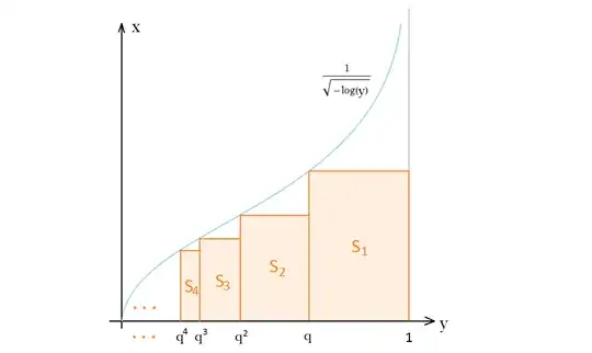

Long time ago in a galaxy far far away ... Ouch, not so far, it was at some shopping centre in Prague, I stumbled upon a question wheather is the integral above derivable in sense of elementary (in some sense) functions to obtain. I claim no originality, but this is what I get :
Let us denote our integral $I$, via substitution $x=\sqrt{-\ln y}$ we have :
$$I=\int_{-\infty}^{\infty}e^{-x^2}\mathrm{d}x=2\int_{0}^{\infty}e^{-x^2}\mathrm{d}x=\int_{0}^{1}\frac{1}{\sqrt{-\ln y}}\,\mathrm{d}y$$
Step back for a second and dream about another meaning of definite integration - namely area under the curve, the area under curve can be approximated by rectangles, if we divide it so that maximum widht goes to zero the sum in the limit goes to original integral - let us choose clever division, namely geometrical sequence $\{y=q^n\}$ with maximal widht equal to the width of ist first rectangle (ergo $1-q$) :
Clearly from the picture above (note : could be generalised) :
$$S_n = \left(q^{n-1}-q^n\right)f(q^n) = q^{n-1}\frac{1-q}{\sqrt{-n\ln q}}$$
Then by riemannian summation on geometrical sequence domain division :
$$\int_{0}^{1}\frac{1}{\sqrt{-\ln y}}\,\mathrm{d}y=\lim_{\; q\to 1^-}\sum_{n=1}^{\infty}S_n=\lim_{\; q\to 1^-}\frac{1-q}{\sqrt{-\ln q}}\sum_{n=1}^{\infty}\frac{q^n}{\sqrt{n}}$$

Moreover, there is even another $$\int_{-\infty}^{\infty}\frac{\mathrm{d}x}{\left(1\!+\!x^2\right)^n} \!=\!\frac{1}{\sqrt{n}}\int_{-\infty}^{\infty}\frac{\mathrm{d}x}{\left(1\!+\!\frac{x^2}{n}\right)^n} \!=\!\frac{1}{\sqrt n}\left( \int_{-\infty}^{\infty}e^{-x^2}\mathrm{d}x\!+\!O\left(\!\frac{1}{n}\!\right)\right)\!=\!\frac{I}{\sqrt{n}}\!+\!O\left(\!\frac{1}{n^{3/2}}\!\right)$$
Hence $$I^2\!=\!\lim_{\; q\to 1^-}\!\sqrt{1-q}\,\sum_{n=1}^{\infty}\left( O\left(\!\frac{q^n}{n^{3/2}}\!\right)\!+\!\int_{-\infty}^{\infty}\frac{q^n}{\left(1\!+\!x^2\right)^n}\, \mathrm{d}x\right)\!=\!\lim_{\; q\to 1^-}\sqrt{1-q}\int_{-\infty}^{\infty} \frac{q\,\mathrm{d}x}{1\!-\!q\!+\!x^2}$$
This integral arisen is the simplest of all of them, since
$$\int_{-\infty}^{\infty} \frac{\mathrm{d}x}{1\!-\!q\!+\!x^2}=\frac{\pi}{\sqrt{1-q}}$$
The result is now obvious...
Little bonus : from the steps throughout the text we can also conclude that $$\sum_{n=1}^{\infty}\frac{x^n}{\sqrt n}\sim\sqrt{\frac{\pi}{1-x}}\qquad \mathrm{as}\qquad x\rightarrow 1$$ an assymptote for the series.
Note : I'm really curious about knowing whether one can resolve also the Basel problem this way (i.e. summing $\sum_{n=1}^{\infty}\frac{1}{n^2}$)

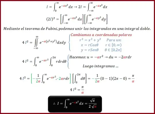

No entender mucho el idioma pero aqui dejo mi solucion en una imagen didactica.
- 81
3This essentially duplicates Ross Millikan's answer, so I don't think it's worth the effort to translate it and write the computation in MathJax markup. But considering the hundreds of answers in English this question has received, I don't think it does much harm to leave one in Spanish here, so I'm not deleting it. – Daniel Fischer May 28 '15 at 14:35
7\begin{align} \underline{Line\ 1}: & \mbox{I don't understand the language 'too much'. Anyway, I leave my solution over here as a didactic image.} \ \underline{Line\ 2}:& \mbox{By means of Fubini Theorem, we can join the integrands in a single double integral.} \ \underline{Line\ 3}: & \mbox{Lets switch to polar coordinates. ( $\color{#f00}{RED}$ text ).} \ \underline{Line\ 4}: & \mbox{We'll do... :$u = -\alpha r^{2}\ldots$.} \ \underline{Line\ 5}: & \mbox{Now, we integrate$\ldots$} \end{align} – Felix Marin Jul 22 '16 at 03:27
