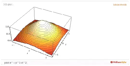

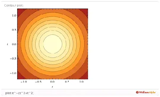

To be precise we are talking not about $\pi$ but about $\sqrt{\pi}$ here. So the circles show up when you square the function which means that you go one dimension up. It follows that in order to see the circles we must look at the two dimensional normal curve:
surface plot
When you look at the contour lines you will see the circles!
surface and contours
This will become even clearer when you have a look at the contour plot!

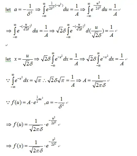

I will supplement the derivation of the formula $$ \int_{\mathbb{R}}e^{-x^2} dx = \sqrt{\pi},$$ which, I think at least, is the center of your question. We start with $$ (\int_{\mathbb{R}}e^{-x^2} dx)^2= \int_{\mathbb{R}}e^{-x^2} dx \int_{\mathbb{R}}e^{-y^2} dy = \int_{\mathbb{R}^2}e^{-(x^2+y^2)} dx dy $$ Now we switch to polar coordinates: $$\int_{\mathbb{R}^2}e^{-(x^2+y^2)} dx dy = \int_{0}^{2 \pi}\underbrace{\int_{0}^{\infty} e^{-r^2} r dr }_{=1/2}\; d \theta =\pi.$$

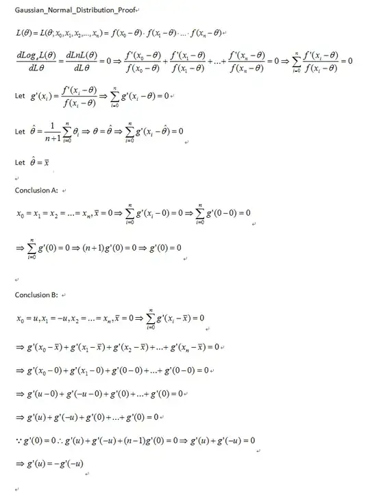

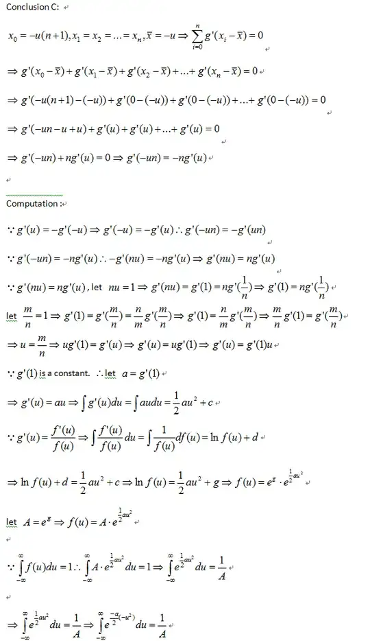

-2
Gaussian Normal Distribution Proof 01enter image description here
