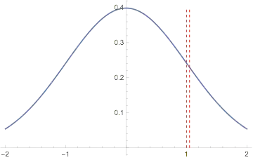

Consider the PDF of the standard normal distribution, $\varphi(x) = \frac{1}{\sqrt{2\pi}} e^{-x^2/2}$ at point $x = 0$, is equal to $\varphi(x) = \frac{1}{\sqrt{2\pi}}$.
Is the value of $\frac{1}{\sqrt{2\pi}}$ a precise or approximate value of the PDF of the standard normal distribution at point $x = 0$?

The probability density function specified just that: the probability a given value arises in a random process governed by the probability density function. Nevertheless, the probability of any specific value $x$ arising (where that value is specified to arbitrary precision) is infinitesimal. Thus, in practice one has a measuring device with a finite resolution, or specifies a value selected to finite precision, and the smaller that range, the closer the measurements are to revealing the density at $x$.
So the ideal function describes infinitesimally small ranges (and thus infinitesimally improbable events), but in any experiment there is a finite range.
Just look at the pdf of a normal distribution and think about the above explanation.
Clear?

  • $\frac{1}{\sqrt{2}}$ is the precise value of the probability density at $x=0$. But the finite probability is $$\lim_{\Delta \to 0} \int\limits_{x - \Delta}^{x+\Delta} p(x)\ dx$$ – David G. Stork Oct 01 '19 at 05:25

    "Finite probability" here colloquially means "non-infinitessimal probability." Given a normal distribution ${\cal N}(0,1)$, the probability of selecting the exact value $x = 1/3$ is infinitesimally small. The probability you select an $x$ in the range $[1/3 - \Delta, 1/3 + \Delta]$ for $\Delta > 0$ is a finite probability. Clear? – David G. Stork Oct 01 '19 at 17:51
As you say, the pdf of the standard normal is $\varphi(x) = \frac{1}{\sqrt{2\pi}} e^{-x^2/2}$. When we evaluate this at $x=0$ the value is exactly $\frac 1{\sqrt{2\pi}}$. It comes from integrating $e^{-x^2/2}$ from $-\infty$ to $\infty$, getting $\sqrt{2 \pi}$ and using that as a normalizing factor. There is nothing approximate about it.
The chance of a random variable having the value exactly $0$ or any other number is $0$. We normally consider the chance the random variable is in some small range around some value. If we consider the range from $-\epsilon$ to $+\epsilon$, the chance a random variable is within that range is approximately $2\epsilon \cdot \frac 1{\sqrt {2 \pi}}$. This is approximate because $\varphi(x)$ is not constant over the interval. It decreases away from $0$. If $\epsilon$ is small, the decrease is small, and the approximation is good.
