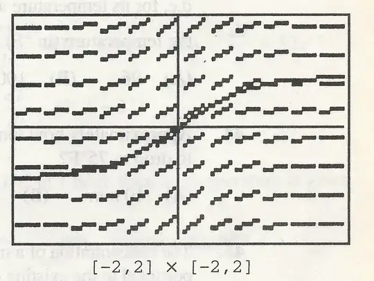

The slope field for $F^{'}(x) = e^{-x^{2}}$ is shown here with a particular solution $F(0)=0$ superimposed. Using calculator, find
$$ \lim_{x \rightarrow \infty} F(x)$$ to $3$ decimal places.

The book says that answer is A, but I want to understand this.

  • I was looking for an explanation that uses the superimposed image. There should be a reason why they gave that. (probably) I kind of knew about Error function by doing web search. – Sam Mar 10 '12 at 18:39
  • @Sam: I have no clue what the image means :-) Anyway, if you are asking us to guess the solution they want, I guess it is impossible unless you give more context. – Aryabhata Mar 10 '12 at 18:42
  • Does $F^{'}(x) = e^{-x^{2}}$ mean $F(x) = \int_{0}^{x} e^{-t^{2}} \text{dt}$ and therefore the expected limit is $\int_{0}^{\infty} e^{-x^2} \text{ dx}$ ? – Sam Mar 10 '12 at 18:46
    @Sam I surmise they want you to (using the calculator) put your crosshair on the right edge of the solution curve and record the $y$-coordinate. – David Mitra Mar 10 '12 at 18:55
  • @Sam: Yes, that and $F(0) = 0$. – Aryabhata Mar 10 '12 at 19:21

I am also curious what calculator is here for. We just need a crude idea of what $\int_0^\infty e^{-x^2}\,dx$ is. Note that $\int_a^{\infty}e^{-x^2}\,dx\le e^{-a^2}\int_0^\infty e^{-2at}\,dt=e^{-a^2}/(2a)$ and that $e^{-4}/4< 0.01$, so we really need only $$ \int_0^2e^{-x^2}\,dx\approx \frac 13(1+4e^{-1}+e^{-4})\approx (1+\frac 4{2.7}+\frac 1{7.29})/3\approx \frac 13+\frac 12+\frac 1{22}=0.83333\dots+0.04545\dots\approx 0.878\dots $$ Of course, Simpson is a slight underestimate here but for the multiple choice, it is perfectly suitable.
Of course, if you happen to know the exact value $\sqrt\pi/2$, the life gets completely trivial.
