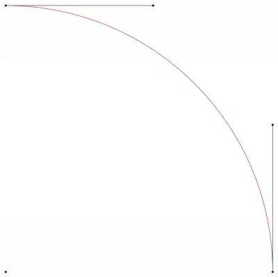

Here is a plot of $\gamma$ in red over the quarter circle in black. We really don't see the circle since it is no more than $0.1$ pixels off from $\gamma$ when the radius is $400$ pixels.

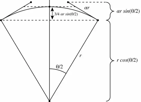

Computation of $\boldsymbol{\alpha}$
Looking at an arc with an angle of $\theta=\cos^{-1}\left(\frac{(p_0-c)\cdot(p_3-c)}{r^2}\right)$
$\hspace{1.5cm}$enter image description here
we see that the distance from $c$ to the middle of the arc is $$ r\cos(\theta/2)+\frac34\alpha r\sin(\theta/2) $$ we wish to choose $\alpha$ so that this is equal to $r$. Solving for $\alpha$ gives $$ \begin{align} \alpha &=\frac43\frac{1-\cos(\theta/2)}{\sin(\theta/2)}\\ &=\frac43\tan(\theta/4) \end{align} $$

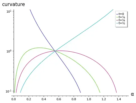

Graphing the curvature for a few values of $t$ helps confirm that intuition (source) curvature for various values of t
($t > 1/2$ not included on the chart due to symmetry.)
Since we're approximating a unit circle we're hoping to get $k(t) ≈ 1$, and those lines seem to intersect around there, at roughly $t ≈ 0.55$.
