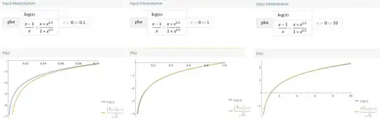

$$\ln(x) \approx \frac{\left(x-1\right)\left(x+x^{\frac23}\right)}{x\left(1+x^{\frac23}\right)}$$
which looks as a decent approximation among $x\in[0.08,\,10]$ (don't know if useful for numerical approximation, but I found it cool anyway).
approximation by Claude Leibovici

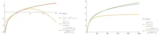

simple approximation
It follows the graph quite good and way longer that the classic approximations just with some little crossovers, but as can be seen at the end, it still detaches from the logarithmic curve as $x$ increases.
Looking at how the approximation was obtained, you can notice that further differentiation could be used to obtain other approximations for the logarithm function, since for every differentiation I will get the form: $$\mathbb{P}_1(x) \approx \mathbb{P}_2(x)+\ln(x)\cdot \mathbb{P}_3(x) \Rightarrow \ln(x) \approx \frac{\mathbb{P}_1(x)-\mathbb{P}_2(x)}{\mathbb{P}_3(x)}$$
with $\mathbb{P}_i(x)$ some polynomial-alike functions (with roots and fractions of combination of roots and polynomials).

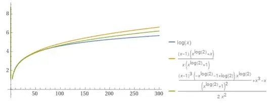

As example, the next step of differentiation leads to the approximation: $$\ln(x)\approx f_2(x) = \frac12 (x-1)^3 \left( \frac{x}{(x-1)^3}-\frac{1}{x(x-1)^3}+\frac{x^{\ln(2)-2}\left(\ln(2)-1-x^{\ln(2)}\right)}{\left(1+x^{\ln(2)}\right)^2}\right)$$
which can be seen in the following figure 3, sacrificing accuracy at the beginning, looks like it is converging for larger values, so I wonder if this process could be indeed giving approximations for the logarithmic function.
2nd approximation
