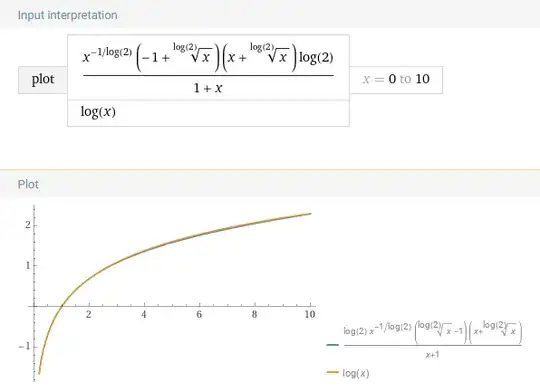

In this other question I found an approximation as follows: $$\ln(x+1) \approx \dfrac{\ln(x)}{1-x^{-\frac{1}{\ln(2)}}}$$
By differentiating both sides, since just one logarithmic terms remains you could find the following approximation: $$\ln(x)\approx \dfrac{\ln(2)\ x^{-\frac{1}{\ln(2)}}\left(x^{\frac{1}{\ln(2)}}-1\right)\left(x^{\frac{1}{\ln(2)}}+x\right)}{1+x}$$
which works pretty good for $x\in [0.1,\ 10]$ as can be seen in Wolfram-Alpha, but it get worst for bigger values of $x$, but anyway, maybe it could be improved knowing how it has been done.

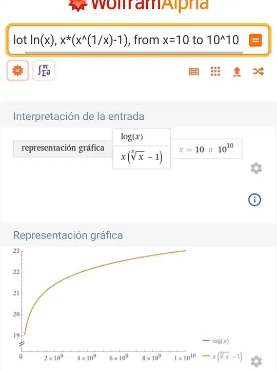

For bigger values of $x$, following this answer, this formula could be used:
$$\ln(x)\approx x\ \left(x^\frac{1}{x}-1\right)$$
approx 2

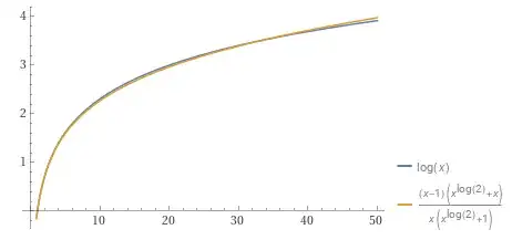

Later I found here that the first approximation could be improved with an even simpler formula, which works quite good for $x\in [0.02,\ 50]$:
$$\ln(x) \approx f_1(x) = \frac{\left(x-1\right)\left(x+x^{\ln(2)}\right)}{x\left(1+x^{\ln(2)}\right)}$$
check its plot:
simpler approx
and it fastly converge to the logarithm by using the function: $$f_n(x) = nf_1(x^{\frac{1}{n}})$$
even for small integer $n>1$.
As extreme example, $\theta(x) = xf_1(x^{\frac{1}{x}})$ is practically the logarithm function when $x>0.65$ (in my humble opinion: the max difference is less than $0.0011$).
