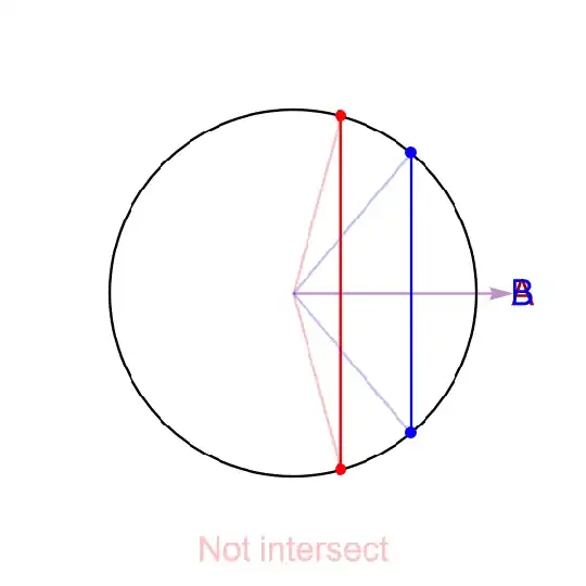

Now let $A$ and $B$ be i.i.d. chords sampled as in OP's scheme. Given that the central angle of $A$ and $B$ are $\alpha$ and $\beta$, respectively, where $\alpha, \beta \in [\frac{\pi}{2}, \pi]$, the probability that $A$ and $B$ intersect is
$$ \mathbf{P}(\text{$A$ and $B$ intersect} \mid \alpha, \beta) = \frac{2\min\{\alpha,\beta\}}{2\pi}. $$
Below is an animation visually proving the above equality:
Visual proof
Since the central angle of $A$ and $B$ are independent and uniformly distributed over $[\frac{\pi}{2}, \pi]$, it follows that
\begin{align*} \mathbf{P}(\text{$A$ and $B$ intersect}) &= \int_{\frac{\pi}{2}}^{\pi}\int_{\frac{\pi}{2}}^{\pi} \mathbf{P}(\text{$A$ and $B$ intersect} \mid \alpha, \beta) \, \frac{\mathrm{d}\alpha}{\pi/2}\frac{\mathrm{d}\beta}{\pi/2} \\ &= \frac{2}{3}. \end{align*}
