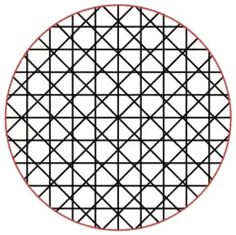

The random radial point method which @SmileyCraft's answer refers to, can be thought of as first drawing $m$ regular polygons, each with $n$ sides, inside the circle, concentric with the the circle and with corresponding sides parallel, with radii that are in uniformly distributed (including a polygon with radius $0$, which is not visible).
Then we extend each side of each polygon, to produce chords of the circle.
Then we let $n$ and $m$ approach infinity (moving from discrete to continuous). It is intuitively obvious that the intersections of the chords are uniformly distributed throughout the circle.
