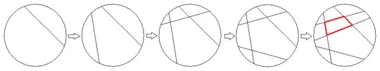

In the following example, a piece with no curved edge is obtained by the fifth random cut.

I tried to find the probability that a piece with no curved edge is obtained by the $n$th random cut. But I only worked out that the probability for $n=3$, is $\frac{1}{15}$. (Consider the six points that define three cuts. Start with one point: it must be paired with its opposite point, which has probability $\frac15$. Then one of the remaining points must be paired with its opposite point, which has probability $\frac13$. The remaining two points must be paired together. So the probability is $\frac15\times\frac13=\frac{1}{15}$.)
