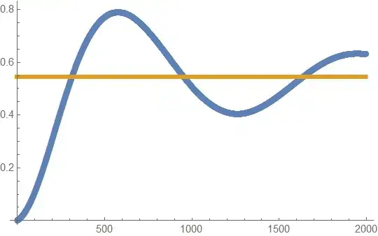

To be absolutely sure that there is no error in the above calculations we compare the expression $(1)$ with the last line $(2)$. We randomly selected $\mu_0,x,b$ then we took $\theta = 999/1000$ and we plot the cumulative sum of the first two thousand terms in the sum in $(1)$ (Blue) against the expression in the last line in $(2)$ (Yellow). As you can see there is a match.
(*The Bromwich integral versus the sum over the zeros of the Bessel \
function. All this in the limit theta --> 1_-.*)
numzrs = 2000; T = 3; myInt[alpha_] := 1/(2 Pi I) (-1 + Exp[alpha T])/ alpha (x/b)^(1/2 - mu0) BesselI[(mu0 - 1/2)/(1 - th), x^(1 - th)/(1 - th) Sqrt[2 alpha]]/ BesselI[(mu0 - 1/2)/(1 - th), b^(1 - th)/(1 - th) Sqrt[2 alpha]]; (This is the limit of the above when theta -->1_-) myIntinf[alpha_] := 1/(2 Pi I) (-1 + Exp[alpha T])/ alpha (b/x)^(mu0b - Sqrt[mu0b^2 + 2 alpha]);
mu0 = RandomReal[{1/2, 1}, WorkingPrecision -> 50]; x = RandomReal[{1, 2}, WorkingPrecision -> 50]; b = RandomReal[{3 x, 10}, WorkingPrecision -> 50]; th = 999/1000; mu0b = mu0 - 1/2; nu = (1 - 2 mu0)/(2 (1 - th)); aa = N@Table[AiryAiZero[k], {k, 1, numzrs}]; myzrs = N[Table[BesselJZero[-nu, xi], {xi, 1, numzrs}], 15]; myzrs1 = N[ Table[(-nu) (1 - aa[[xi]]/2^(1/3) (-nu)^(-2/3)), {xi, 1, numzrs}], 15]; (The Bromwich integral) (resinf=I NIntegrate[myIntinf[I
alpha],{alpha,-Infinity,Infinity},WorkingPrecision[Rule]15,
PrecisionGoal[Rule]12]
) resinf = 1/ 2 (Erfc[(-mu0b T + Log[b/x])/ Sqrt[2 T]] + (b/x)^(2 mu0b) Erfc[(mu0b T + Log[b/x])/ Sqrt[2 T]]);
(Sum over the residues.) res1 = Accumulate[ Table[2 I (1 - E^(-(1/2) b^(-2 + 2 th) T (1 - th)^2 myzrs[[xi]]^2)) (x/b)^( 1/2 - mu0)
BesselI[-nu, I (x/b)^(1 - th) myzrs[[xi]]]/((D[ BesselI[-nu, z], z] /. z :> I myzrs[[xi]]) myzrs[[xi]]), {xi, 1, Length[myzrs]}]]; ListPlot[{res1, Re@resinf ConstantArray[1, {numzrs}]}, Joined :> True, PlotMarkers -> Automatic, PlotRange -> All]
