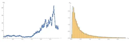

Clearly $(7)$ is the correct result as the Monte Carlo simulation below demonstrates:
(*Monte Carlo simulation of 1st hitting time distribution.*)
mu0 = 1; Clear[Bs]; x = Exp[3/2]; b = Exp[2]; NN = 750; numInst = 50000; dt = 1/256 ; myHist = {}; Do[ Bs = RandomVariate[NormalDistribution[0, 1], NN]; Xs = Drop[FoldList[#1 + mu0 #1 dt + #1 #2 Sqrt[dt] &, x, Bs], -1]; ts = dt Range[1, NN]; tHit = Min[Flatten[Position[Sign[Xs - b], _?(# == 1 &), 1]]] dt; myHist = Join[myHist, {tHit}]; If[Mod[which, 5000] == 0, PrintTemporary[which]]; , {which, 1, numInst}];
b = Exp[2]; line1 = Line[{{tHit, 0}, {tHit, b}}]; line2 = Line[{{0, b}, {tHit, b}}]; pl1 = ListPlot[Transpose[{ts, Xs}], Joined :> True, PlotMarkers -> Automatic, Epilog -> {line1, line2}, AxesLabel :> {"t", "X[t]"}];
b =.; pl20 = Histogram[myHist, {0, NN dt, 0.05}, "PDF", AxesLabel -> {Subscript[[Tau], b], Subscript[[Rho], Subscript[[Tau], b]]}]; b = Exp[2]; mpdf[t_, x_, b_, mu0_] := 1/Sqrt[2 Pi] Log[b/x] 1/ t^(3/2) Exp[-1/(2 t) (Log[b/x] - (mu0 - 1/2) t)^2]; pl21 = Plot[mpdf[t, x, b, mu0], {t, 0, NN dt}, PlotRange :> All]; b =.; pl2 = Show[pl20, pl21];
GraphicsGrid[{{pl1, pl2}}]

  • The mistake I made was that I erroneously took the minus sign in equation (4) instead of taking the plus sign. If you look at the proof of the theorem in question (see section 4.6 page 129) in Ito&McKean then you see that if $x<b$ (or $x>b$) then the Laplace transform equals $u_\alpha^{(b)}(x)/u_\alpha^{(b)}(b)$ where $u(x)$ is a unique , strictly increasing (or decreasing) eigen-function of the infinitesimal generator to the eigenvalue $\alpha$. The choice of the plus sign is therefore obvious. The normalization can be then enforced by a multiplicative constant. – Przemo Mar 20 '24 at 14:31

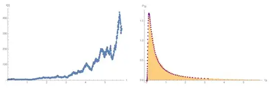

Now we show that the quantity in $(5a)$ matches perfectly the Monte Carlo simulation of the model in question. We took the same parameters as in the simulation of the geometric Brownian motion , i.e. $x,b,\mu_0 = \exp(3/2), \exp(2), 1$ then we took the exponent $\theta = 0.9$ and we ran the simulation in the same way as in the body of the question above. Here we go:
(*Monte Carlo simulation of 1st hitting time distribution for the \
elasticity of variance model.*)
{x, b, mu0} = {Exp[3/2], Exp[2], 1};
th = 9/10; g = 0; dt = 1/256 ; NN = 1500; numInst = 50000;
nu = (1/2 - mu0)/(1 - th);
(Run simulation) myHist = {}; Do[ Bs = RandomVariate[NormalDistribution[0, 1], NN]; Xs = Drop[ FoldList[#1 + mu0 #1^(2 th - 1) dt + #1^(th) #2 Sqrt[dt] &, x, Bs], -1]; ts = dt Range[1, NN]; tHit = Min[Flatten[Position[Sign[Xs - b], _?(# == 1 &), 1]]] dt; myHist = Join[myHist, {tHit}]; If[Mod[which, 5000] == 0, PrintTemporary[which]]; , {which, 1, numInst}]; B =.; pl2a = Histogram[myHist, {0, NN dt, 0.05}, "PDF", AxesLabel -> {Subscript[[Tau], B], Subscript[[Rho], Subscript[[Tau], B]]}]; line1 = Line[{{tHit, 0}, {tHit, b}}]; line2 = Line[{{0, b}, {tHit, b}}]; pl1 = ListPlot[Transpose[{ts, Xs}], Joined :> True, PlotMarkers -> Automatic, Epilog -> {line1, line2}, AxesLabel :> {"t", "X[t]"}];
(Find result theoretically) {x, b, mu0} = {Exp[3/2], Exp[2], 1}; th = 0.9; ts = Array[10^# &, 100, {-2, 1/2}]; (* vals=Map[Function[t,1/(2 Pi) ( NIntegrate[ Exp[(I alpha+g) t] (x/b)^(1/2-mu0)
BesselI[-nu,x^(1-th)/(1-th) Sqrt[2 (I alpha+g)]]/
BesselI[-nu,b^(1-th)/(1-th) Sqrt[2 (I
alpha+g)]],{alpha,-Infinity,Infinity},WorkingPrecision[Rule]12,
PrecisionGoal[Rule]15] )],ts]; pl2b=ListPlot[Transpose[{ts,Re@vals}],PlotRange[RuleDelayed]All,
PlotStyle[RuleDelayed]Blue]; *)
Clear[mpdf]; t =.; mpdf[t_, mu0_, x_, b_] := Total[Flatten@ Table[(1 - th)^n mat[[1 + n, 1 + If[n == 0, 0, (3 n - 1)] + j]] 1/ Sqrt[t] rho[(Log[b/x] - (mu0 - 1/2) t)/Sqrt[t]] HermiteH[j + 1, Log[b/x]/Sqrt[2 t]]/(2 t)^(j/2 + 1/2), {n, 0, M}, {j, If[n == 0, 0, -(3 n - 1)], n}]]; vals1 = Map[Function[t, N@mpdf[t, mu0, x, b]], ts]; pl2c = ListPlot[Transpose[{ts, vals1}], PlotRange :> All, PlotStyle :> Purple];
pl2 = Show[pl2a, pl2c]; GraphicsGrid[{{pl1, pl2}}]
As you can see the analytical inverse Laplace transform in $(5a)$ matches the histogram of the first hitting times (the purple dots match the yellow bars in the right plot).
