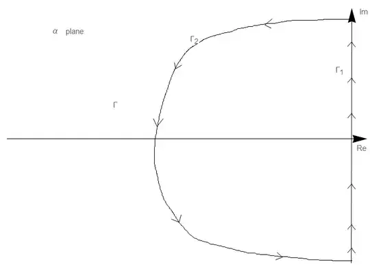

We use the Cauchy residue theorem as applied to the contour below:
Bear in mind that we took $\nu = 1/2$. Then the modified Bessel function in question is given in closed form and we know that the Laplace transform $u_\alpha^{(b)}(x) $ does not have any poles in the negative complex half plane. Therefore we can just write:
\begin{eqnarray} \frac{1}{2\pi \imath} \int\limits_{\Gamma_1} e^{\alpha \cdot t} \cdot u_\alpha^{(b)}(x) d\alpha + \frac{1}{2\pi \imath} \int\limits_{\Gamma_2} e^{\alpha \cdot t} \cdot u_\alpha^{(b)}(x) d\alpha = 0 \\ \Leftrightarrow \rho_{\tau_b}(t) + \frac{1}{2\pi} \left( \frac{b}{x} \right)^{\mu_0-\theta/2} \int\limits_{\pi/2}^{3/2\pi} e^{R e^{\imath \phi} t} e^{-\sqrt{2} \sqrt{R e^{\imath \phi}} {\mathfrak A}(x,b)} \imath R e^{\imath \phi} d\phi = 0 \end{eqnarray} Now, clearly the second integral above disappears in the limit $R \rightarrow +\infty$ because $Re[ R e^{\imath \phi} ] <0 $ for $\phi \in [\pi/2,3/2\pi] $.
This would imply that our probability distribution is just identically zero which is obviously wrong.
Where is then the error in my reasoning?

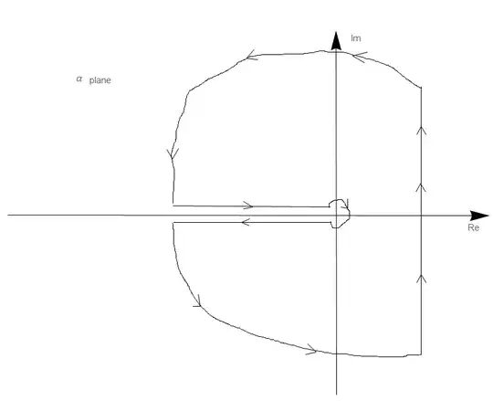

Owing to to Steven Gubkin's comment above and also to a great blog post on those things we can give an answer straight away. Here we do this for $\nu= 1/2$ only but it might be possible to do it in general ; we simply need to identify all the branching points in the later case.
Let us assume that $\nu= 1/2$. We apply the Cauchy theorem to the contour below where the distance of the vertical line in the positive half-plane from the imaginary axis is $c$ and the radius of the circle is $R$. We have:
Again, by means of the Cauchy theorem the sum of the five integrals below is equal to zero. We have:
\begin{eqnarray} \int\limits_{c - \imath \sqrt{R^2-c^2}}^{c + \imath \sqrt{R^2-c^2}} d\alpha e^{-\sqrt{2} {\mathfrak A} \sqrt{\alpha}} \cdot e^{\alpha t} + \underline{\int\limits_{\frac{\pi}{2} - \arcsin(\frac{c}{R})}^\pi R\imath e^{\imath \phi} d\phi \cdot e^{-\sqrt{2} {\mathfrak A} \sqrt{R e^{\imath \phi}}} \cdot e^{R e^{\imath \phi} t}} + \int\limits_0^R e^{-\sqrt{2} {\mathfrak A} \imath \sqrt{\alpha}} \cdot e^{-\alpha t} d\alpha - \int\limits_0^R e^{+\sqrt{2} {\mathfrak A} \imath \sqrt{\alpha}} \cdot e^{-\alpha t} d\alpha + \underline{\int\limits_{\pi}^{\frac{3 \pi}{2} + \arcsin(\frac{c}{R})} R\imath e^{\imath \phi} d\phi \cdot e^{-\sqrt{2} {\mathfrak A} \sqrt{R e^{\imath \phi}}} \cdot e^{R e^{\imath \phi} t}} = 0 \end{eqnarray}
I think that everything above is pretty straightforward except for one thing, i.e. that as we go around the small circle next to the origin we gain a phase, i.e. $\sqrt{\alpha} \rightarrow - \sqrt{\alpha} $ and that is why the integrals along the horizontal intervals next to the negative real axis do not cancel each other.
Now let us analyze the second an the fifth terms. We have:
\begin{eqnarray} &&2nd + 5th= \\ &&\int\limits_{\frac{\pi}{2} - \arcsin(\frac{c}{R})}^{\frac{3\pi}{2} + \arcsin(\frac{c}{R})} R\imath e^{\imath \phi} d\phi \cdot e^{-\sqrt{2} {\mathfrak A} \sqrt{R e^{\imath \phi}}} \cdot e^{R e^{\imath \phi} t} \underbrace{=}_{\zeta = e^{\imath \pi}} \\ &&\int\limits_{\frac{c}{R} + \imath \sqrt{1- \frac{c^2}{R^2}}}^{\frac{c}{R} - \imath \sqrt{1- \frac{c^2}{R^2}}} d\zeta e^{-\sqrt{2}{\mathfrak A} \sqrt{R \zeta}} \cdot e^{R \zeta t} \underbrace{=}_{R\rightarrow \infty}\\ && \int\limits_{\frac{c}{R} + \imath}^{\frac{c}{R}-\imath} d \zeta e^{R \zeta t} = \\ && e^{c t} (-2 \imath) \frac{\sin(R t)}{R t} \underbrace{=}_{R \rightarrow \infty} \\ && (-2\imath \pi) e^{c t} \delta(t) \end{eqnarray}
We can see that except for $t=0$ the contribution from the arcs in the contour vanish. We are therefore left with three terms only. In the limit $R \rightarrow \infty$ we have:
\begin{eqnarray} &&\int\limits_{c - \imath \infty}^{c + \imath \infty} e^{-\sqrt{2} {\mathfrak A} \sqrt{\alpha}} \cdot e^{\alpha t} d\alpha = \int\limits_0^\infty \left[ e^{+\sqrt{2} {\mathfrak A} \imath \sqrt{\alpha}} - e^{-\sqrt{2} {\mathfrak A} \imath \sqrt{\alpha}}\right] e^{-\alpha t} d\alpha \\ % 1st &&= 2 \imath \cdot e^{- \frac{{\mathfrak A}^2}{2 t}} \cdot Im \left[ \int\limits_0^\infty e^{-t(\beta - \frac{{\mathfrak A}}{\sqrt{2} t} \imath)^2} 2 \beta d\beta\right] \\ % 2nd &&= 2 \imath \cdot e^{- \frac{{\mathfrak A}^2}{2 t}} \cdot Im \left[ \int\limits_{{\mathbb R}_+ } e^{-t \beta^2} 2\left[\beta + \frac{{\mathfrak A}}{\sqrt{2} t} \imath\right] d\beta + \int\limits_{\imath [-\frac{{\mathfrak A}}{\sqrt{2} t}, 0] } e^{-t \beta^2} 2\left[\beta + \frac{{\mathfrak A}}{\sqrt{2} t} \imath\right] d\beta \right] \\ %3 rd &&= 2 \imath \cdot e^{- \frac{{\mathfrak A}^2}{2 t}} \cdot Im\left[ \int\limits_{{\mathbb R}_+} e^{-t \beta^2} 2 \frac{{\mathfrak A}}{\sqrt{2} t} \imath d\beta \right] \\ &&= 2 \imath \cdot e^{- \frac{{\mathfrak A}^2}{2 t}} \cdot \frac{{\mathfrak A}}{\sqrt{2} t^{3/2}} \cdot 2 \underbrace{\int\limits_0^\infty e^{-\beta^2} d\beta}_{ \frac{\sqrt{\pi}}{2}} \\ && = 2 \imath \cdot e^{- \frac{{\mathfrak A}^2}{2 t}} \cdot \frac{{\mathfrak A}}{\sqrt{2} t^{3/2}} \cdot \sqrt{\pi} \\ && (2\pi \imath ) \cdot e^{- \frac{{\mathfrak A}^2}{2 t}} \cdot \frac{{\mathfrak A}}{t^{3/2}} \cdot \frac{1}{\sqrt{2\pi}} \end{eqnarray}
Note: The step from the second to the third line involves a substitution $\beta - {\mathfrak A} \imath/(\sqrt{2} t) \rightarrow \beta$ and then using the Cauchy theorem applied to an infinite strip in the forth quadrant.
Then we need to multiply the result by the prefactor $(b/x)^{\mu_0 - \theta/2} $ and we retrieve the pdf of the first hitting time from the body of the question. q.e.d.

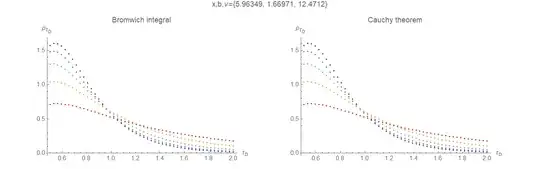

Here we provide an answer for arbitrary $\nu > 0 $. We use the same contour as in my answer above. Now in order to proceed we need to identify the poles and the branching point of the Laplace transform $u_\alpha^{(b)}(x) $. Since the modified Bessel function of the second kind is multi-valued at the origin only there will be one branching point, namely at $\alpha= 0 $. In addition to this there might be poles, which are zeros of the denominator. From here we learn that in the right half-plane (positive real part) there are no zeros. All the zeros of the function in question are located in the interior of the second and the third quarters.This means that the potential poles of the Laplace transform have to satisfy:
\begin{equation} \sqrt{2} \frac{b^{1-\theta}}{1-\theta} \cdot \sqrt{\alpha} = z \tag{1} \end{equation} where $|Arg[z]| > \pi/2$ (with the convention that $Arg[z] \in [-\pi,\pi]$. But equation $(1)$ does not have any solutions in $\alpha$ (this is because the square root of a complex number has an argument that is always between $-\pi/2$ and $\pi/2$. Therefore there are no poles.
On the other hand the contribution from the branching point (at the origin) comes from two terms, the first one being an integral of the integrand over $(-R,0)$ and the second one being an integral of the integrand evaluated at $\sqrt{\alpha} \rightarrow - \sqrt{\alpha} $, an integral taken over $(0,-R)$.
This gives us the following formula below:
\begin{eqnarray} \rho_{\tau_b}(t) &=& &&\left( \frac{x}{b} \right)^{\nu(1-\theta)} \frac{1}{\pi} \int\limits_0^\infty Im\left[ \frac{K_\nu[\sqrt{2} \frac{x^{1-\theta}}{1-\theta} (-\imath) \sqrt{\alpha}] }{K_\nu[\sqrt{2} \frac{b^{1-\theta}}{1-\theta} (-\imath) \sqrt{\alpha}] } \right] \cdot e^{-\alpha t} d\alpha \tag{1} \end{eqnarray}

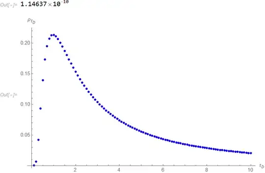

Below we fixed $x,b,\nu$(as in the caption of the plot) and we plotted the probability distribution of the first hitting time $\tau_b$ as a function of time for different values of $\theta=linspace(0.6,09,5)$ (from violet to red respectively). Here the numerical calculation (based on the Bromwich integral) and the analytical result (based on $(1)$) are on the left and on the right respectively. As we can see there is a perfect match .
(*Run (*Procedure for finding zeros *) before running the below.*)
(*For the Bromwich integral to exist we must have: x> b. This is \
because BesselK[z] ~ Exp[-z]/Sqrt[z] as |z| --> Infinity and |arg[z]| \
< 3/2 Pi.*)
(Now we need to satisfy the condition (6a), i.e. the Laplace
transform below must vanish at x-->-Infinity. This is equivalent to
Cos[Pi (1-th)] >0 which is equivalent to Pi \in [1/2,3/2] - 2 Z.
) ths = Array[# &, 5, {6/10, 9/10}]; cols = Table[ ColorData["Rainbow", i/(Length[ths] - 1)], {i, 0, Length[ths] - 1}]; (mu0 = 1/2-nu(1-th);) Clear[LT]; LT[alpha_, b_, th_] := ( x^(nu (1 - th)) BesselK[nu, (Sqrt[2] Sqrt[(alpha)] x^(1 - th))/(1 - th)])/( b^(nu (1 - th)) BesselK[nu, (Sqrt[2] Sqrt[(alpha)] b^(1 - th))/(1 - th)]); zs = Array[# &, 50, {1/2, 2}]; (Compute numerically.) vals = Table[ NIntegrate[ Exp[I alpha #] LT[I alpha, b, ths[[ii]]], {alpha, -Infinity, +Infinity}]/(2 Pi) & /@ zs, {ii, 1, Length[ths]}];
vals1 = Table[(x/b)^(nu (1 - ths[[ii]])) ( (1/Pi) NIntegrate[ 2 beta Im[ BesselK[ nu, (Sqrt[2] x^(1 - ths[[ii]]))/( 1 - ths[[ii]]) (-I) beta]/ BesselK[ nu, (Sqrt[2] b^(1 - ths[[ii]]))/( 1 - ths[[ii]]) (-I) beta ]] Exp[-beta^2 #], {beta, 0, Infinity}]) & /@ zs, {ii, 1, Length[ths]}]; str = ToString[{x, b, nu}]; b =.; pl1 = ListPlot[Table[Transpose[{zs, vals[[ii]]}], {ii, 1, Length[ths]}], PlotStyle :> cols, AxesLabel :> {Subscript[[Tau], b], Subscript[[Rho], Subscript[[Tau], b]]}, PlotLabel :> "Bromwich integral", ImageSize :> 400]; pl2 = ListPlot[ Table[Transpose[{zs, vals1[[ii]]}], {ii, 1, Length[ths]}], PlotStyle :> cols, AxesLabel :> {Subscript[[Tau], b], Subscript[[Rho], Subscript[[Tau], b]]}, PlotLabel :> "Cauchy theorem", ImageSize :> 400]; GraphicsGrid[{{pl1, pl2}}, PlotLabel -> "x,b,[Nu]=" <> str]

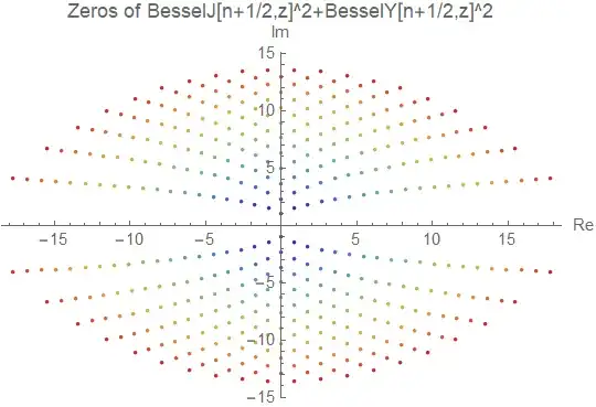

b =.; num = 20;
(*Roots of the denominator.*)
cols = Table[ColorData["Rainbow", i/(num - 1)], {i, 0, num - 1}];
dens = Table[ Sum[ Pochhammer[n - j + 1, 2 j] (b)^(2 (n - j)) (2 j - 1)!!/( 2^j j!), {j, 0, n}], {n, 0, num}];
ListPlot[Transpose[{Re[#], Im[#]}] & /@ ((b /. NSolve[# == 0, b]) & /@ Drop[dens, 1]), PlotStyle -> cols, AxesLabel :> {"Re", "Im"}, PlotLabel :> "Zeros of BesselJ[n+1/2,z]^2+BesselY[n+1/2,z]^2"]
The final, seventh line, we used the identity ${\mathfrak C}^{(n,j)}_\xi + (-1)^j {\mathfrak C}^{(n,j)}_{2 n+1-\xi} = 0$ for $\xi=1,\cdots,n$ and $j=0,\cdots,2n+1$. Then we also used the fact that $\zeta^{(n)}_{2n+1-\xi} = \bar{\zeta^{(n)}_\xi}$, i.e. the $\xi$th and the $(2n+1-\xi)$th roots are complex conjugates.

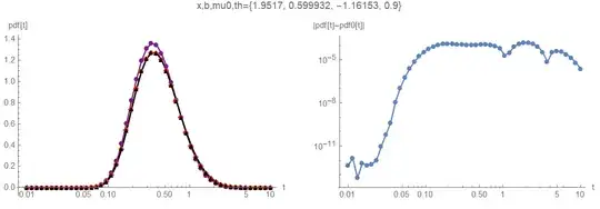

Now we have taken $\theta = 0.9$ and then we have chosen randomly $x,b,\mu_0$ subject to $x > b >0$ and $\mu_0 < 1/2$ and we produced two plots. On the left we plotted the cumulative sum of the first three modes ($n=0,\cdots, 2$) in equation $(2)$ above (violet to red for ascending values of $n$) along with the Bromwich integral itself (black). On the right we showed the absolute value of the difference between equation $(2)$ being truncated at $n=2$ and the Bromwich integral itself.
(*Compute the pdf of the first hitting time as a power series in \
(1-th).Run the block (*Here, we invert the Laplace transform *) to \
generate the quantities res[[]] first.*)
x =.; b =.; mu0 =.; th =.; t =.;
mypdf = (x/b)^(1/2 - mu0) Table[
    Sum[mcfs[[1 + n]][[j + If[n == 0, 1, 3 n], 1]] 1/
        8 Exp[-1/2 (mu0 - 1/2)^2 t] (t/8) ^(-1 -
        j/2) (Hypergeometric1F1[1 + j/2, 1/2, -(Log[x/b]^2/(2 t))]/
         Gamma[-(j/2)] - (

As we can see for $\theta = 0.9$ truncating the expansion $(2)$ at the first three terms, $n \le 2$, is completely sufficient for practical purposes.
