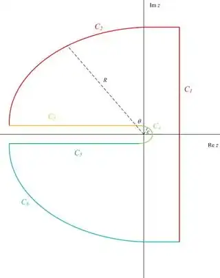

where $C$ is the following contour:
contour
We will define $\text{Arg}{z} \in (-\pi,\pi]$, so the branch is the negative real axis. There are $6$ pieces to this contour, $C_k$, $k \in \{1,2,3,4,5,6\}$, as follows.
$C_1$ is the contour along the line $z \in [c-i R,c+i R]$ for some large value of $R$.
$C_2$ is the contour along a circular arc of radius $R$ from the top of $C_1$ to just above the negative real axis.
$C_3$ is the contour along a line just above the negative real axis between $[-R, -\epsilon]$ for some small $\epsilon$.
$C_4$ is the contour along a circular arc of radius $\epsilon$ about the origin.
$C_5$ is the contour along a line just below the negative real axis between $[-\epsilon,-R]$.
$C_6$ is the contour along the circular arc of radius $R$ from just below the negative real axis to the bottom of $C_1$.
We will show that the integral along $C_2$and $C_6$ vanish in the limits of $R \rightarrow \infty$ and $\epsilon \rightarrow 0$.

On $C_2$, the real part of the argument of the exponential is
$$R t \cos{\theta} - (r-1)\sqrt{R} \cos{\frac{\theta}{2}}$$
where $\theta \in [\pi/2,\pi)$. Clearly, $\cos{\theta} < 0$ and $\cos{\frac{\theta}{2}} > 0$, so that the integrand exponentially decays as $R \rightarrow \infty$ and therefore the integral vanishes along $C_2$.
On $C_6$, we have the same thing, but now $\theta \in (-\pi,-\pi/2]$. This means that, due to the evenness of cosine, the integrand exponentially decays again as $R \rightarrow \infty$ and therefore the integral also vanishes along $C_6$.
Thus, we are left with the following by Cauchy's integral theorem (i.e., no poles inside $C$):
$$\left [ \int_{C_1} + \int_{C_3} + \int_{C_4} + \int_{C_5}\right] \frac{dz}{z} \: e^{z t} \frac{K_0(\sqrt{z} r)}{K_0(\sqrt{z})} = 0$$
On $C_4$, note that the integral is finite and nonzero as $\epsilon$ in the limit $\epsilon \rightarrow 0$:
$$\int_{C_4} \frac{dz}{z} \exp{(t z)} \frac{K_0(\sqrt{z} r)}{K_0(\sqrt{z})} \sim i \int_{\pi}^{-\pi} d\phi = -i 2 \pi $$

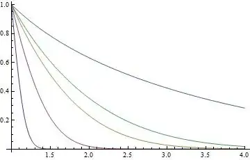

Here are some plots of the temperature $u(r,t)$ for $r \in (1,4]$ and $t \in \{0.01,0.1,0.5,1.0,10\}$:
These were generated in Mathematica directly from the integral expression above.

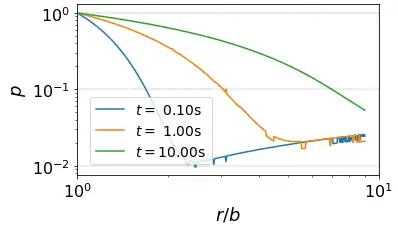

I computed the solution with scipy, and obtained the same results as Ron Gordon (fortunately!), as shown in the figure ($b = r_D$). The integration is somehow off for large values of $r/b$. Depending on the case, it may be relevant or not.
