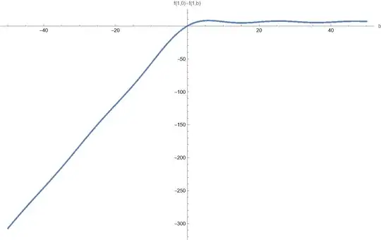

The difference of the special solution to the general solution $f(1,0)-f(1,b)$ is calculated numerically for $a=1$ and $-50<b<50$.

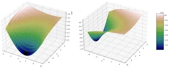

I tried various approaches to get a result computationally - without success. Then I decided to iterate (using two nested loops) both variables $a,b$, the first variable $a$ from $0.1$ to $10.1$ by steps of $0.5$ and the second variable $b$ from $-5$ to $5$ by steps of $0.5$. Whithin these loops, I am calculating the integral numerically and plot the surface of this function depending from both variables $a$ and $b$. To get a rough idea of that integral, here is my first picture:
Computation took hours and I need to optimize the code. After this I will be able to expand the iteration range. Hope this helps a bit.
Here is the code, if anyone would like to run it:

Update (2021-12-31):
I ammended the code, performed a new run and updated the figure above that contains the plot.
