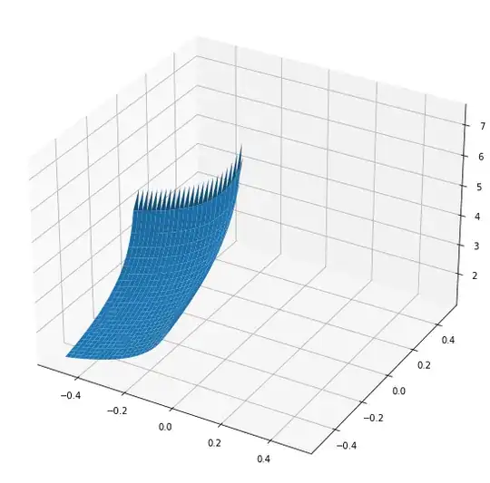

When I for example integrate $e^{-x*y}$ numerically, I can obtain via the following algorithm the figure below:
arr_x = np.arange(-0.5,0.5,0.01)
arr_y = np.arange(-0.5,0.5,0.01)
X,Y = np.meshgrid(arr_x, arr_y)
Z = np.empty([arr_x.size, arr_y.size])
Z[:] = np.nan
f = lambda y, x: np.exp(-x*y)
def integrand(x, y): m = integrate.dblquad(f, -np.inf, x, lambda x: -np.inf, lambda x: y) return m[0]
for idx_x, x in enumerate(arr_x): if x < 0: for idx_y, y in enumerate(arr_y): if y < 0: Z[idx_x][idx_y] = integrand(x, y)
fig = plt.figure(figsize=(14,10)) ax1 = fig.add_subplot(111, projection='3d') surf1 = ax1.plot_surface(X, Y, Z) plt.show
This plot seems to be correct when checking it with Wolfram Alpha. But this case is an easier one, since my starting point for integration were not two partial derivatives. Is it possible to transfer this numerical procedure to the case having two PDEs?
