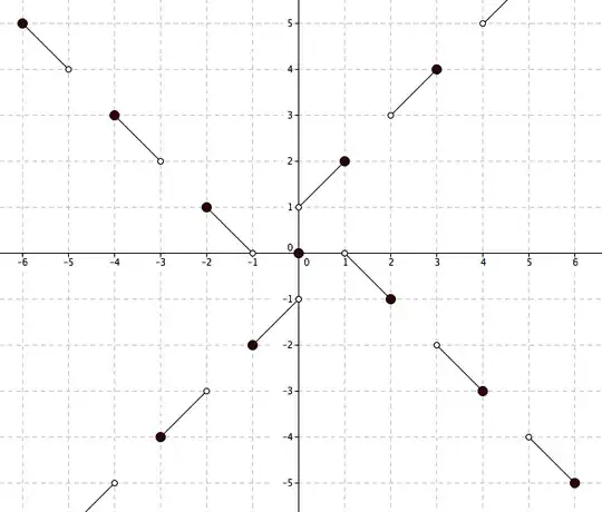

If $f$ is odd, then the equation boils down to $f(f(a))=-a$. This equation has been asked about on MSE before. Alex Jordan's answer mentions the function $g(x)=\frac{x}{|x|}-(-1)^{\lceil|x|\rceil}x$ which looks almost identical to the function you asked about in your question (the only difference is the behaviour of the function at the endpoints of each line segment):
Solution to f(f(a))=-a
This visual tells us something important. While the formulae describing the functions $f$ and $g$ look formidable, the graphs of the functions themselves are fairly simple-looking. It's easy to see that the above graph describes a function which satisfies your equation—the hard part is finding a concise formula that describes the function. Almost certainly the person who conceived of this example thought of the graph first, and only then found a clever way of describing the function using a formula.
