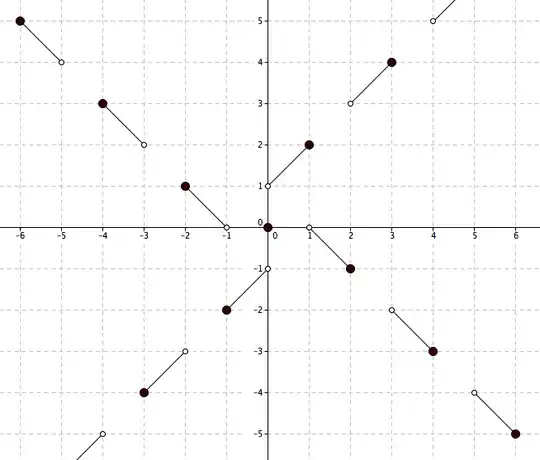

66
Here is a graph of one such function, piecewise continuous.
Graph of a function satisfying f(f(x))=-x

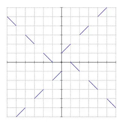

Here's another picture to clarify endpoint behavior.
2'5 9'2

    Nice pictorial solution. It actually looks like a windmill of sorts, but when you look at it again, the function passes the vertical line test. – Joe Z. Feb 25 '13 at 05:08

    @Joe and the horizontal line test too, as such a function needs to be one-to-one. – 2'5 9'2 Feb 25 '13 at 05:26
    As the OP points out in a comment to his question: $f(x) = f^{-1}(-x)$. Since inverting a function flips its graph over the line $y=x$, and since negating a function's argument flips its graph over the $y$-axis, the graph of $f^{-1}(-x)$ must be a rotation of the graph of $f(x)$ through $90$ degrees about the origin; because the graph of $f^{-1}(-x)$ must also coincide with the graph of $f(x)$ itself, we see that the graph itself must have four-fold rotational symmetry, as indeed yours does. – Blue Feb 25 '13 at 06:25
  • What software was used to draw this? – Aaron John Sabu May 15 '17 at 17:55
    @AaronJohnSabu It has been a very long time, but I think probably GeoGebra, and then a screen shot capture. – 2'5 9'2 May 15 '17 at 19:48
