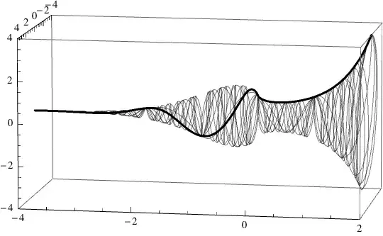

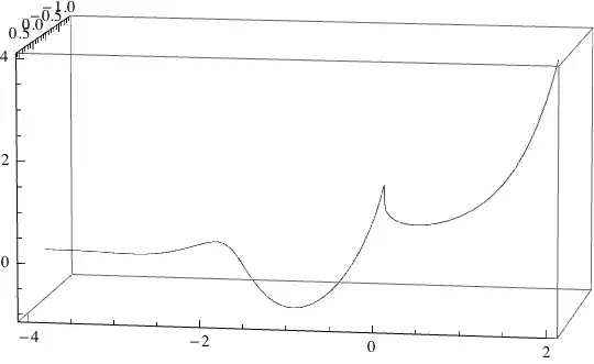

As far as $x^x$ goes, the plot does indeed show the real and imaginary parts of the principal value of $x^x$ on the same axis. Another approach is to plot the complex point itself in a plane that's perpendicular to the $x$-axis at the corresponding point. This leads to a spectacular image called the $x^x$-spindle, which was described in a great paper in Mathematics Magazine back in 1996. This looks like so:
Using the fact that the complex logaritm is multi-valued, this can be generalized to obtain more threads on the spindle:

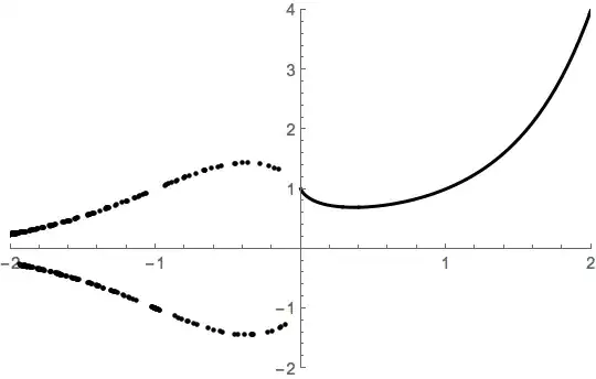

It sounds like you've seen the claim that $(p/q)^{p/q}$ is defined for $p$ negative and $q$ odd and positive. Thus the graph might look something like so.
From the complex perspective, the dots arise as spots where one of the spiral threads punctures the $x$-$z$ plane.

  • What is the minimum value in image #1? Also, $(-1)^{-1}$ is $-1$ and not $1$. – Lee Sleek May 17 '13 at 18:41
  • @LeeSleek I don't understand the question. – Mark McClure May 17 '13 at 18:45
  • In the first image, the graph experiences a dip after it passes the y-axis, and then rises again. What value of x produces the smallest value there? – Lee Sleek May 17 '13 at 18:58
  • Thanks for the answer as well. – Lee Sleek May 17 '13 at 19:06
  • I also notice that in image number two, at the place where the graph reaches its minimum the the threads of the spindle disappear. Again, why is that? – Lee Sleek May 18 '13 at 01:22

  • I was referring to the dip within the negative numbers. – Lee Sleek May 20 '13 at 21:44
  • @LeeSleek Based on the real plane, the minimum of $x^{x}$ in the negative domain must have rational x-value that has an odd integer as a numerator and an odd integer as a denominator(odd/odd). Otherwise, the minimum fails to exist. Now if you know that $x^x$ is equal to $(-x)^{x}$ for (-odd/odd) values you will find that the minimum is at $x=-\frac{1}{e}$. Since the x-value is already irrational, there is no minimum. – Arbuja Dec 09 '15 at 20:59
