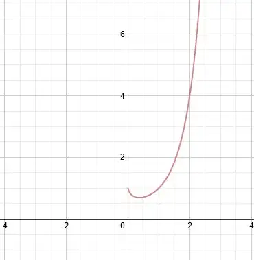

I have a question about the graph of $f(x) = x^x$. How come the graph doesn't extend into the negative domain? Because, it is not as if the graph is undefined when $x=-5$. But according to the graph, that seems to be the case. Can someone please explain this?

    Negative numbers cannot be raised to arbitrary real powers and produce real outputs. Just consider what $(-1/2)^{-1/2}$ would be. However you can extend this function in a "nice" way by looking at $|x|^x$. – 2'5 9'2 May 21 '13 at 15:28
  • @alex.jordan I put $(-1/2)^{-1/2}$ and I get imaginary but when I put $(-5)^{-5}$ I get answer that is $-0.00032$. Can you provide more detail please? – Jeel Shah May 21 '13 at 15:50
    @gekkostate Raising a negative number to a whole number is not a problem. $(-5)^{-5}$ means $1/((-5)(-5)(-5)(-5)(-5))$. But $x^{-1/2}$ should be a square root of $x$,and if $x$ is negative, no square roots are real. And then there are things like $(-2)^{\pi}$. What would that possibly mean to you? At least with $2^{\pi}$ we could approximate $\pi$ with a rational number $m/n$ and $2^{\pi}$ would be something close to $\sqrt[n]{2^m}$. But for negative bases we'll have trouble executing that $\sqrt[n]{}$. – 2'5 9'2 May 21 '13 at 15:56
  • Graphing Calculators have trouble graphing points. (So it is defined for $x=-5$: $(-5)^{-5}=\displaystyle\frac{1}{(-5)^5}=-\frac{1}{3125}= -0.00032$. On my Graphing Calculator, a TI89 Titanium, the points do not show, but if I plug in the value $x=-5$, I get $-0.00032$ – Justin May 21 '13 at 20:04

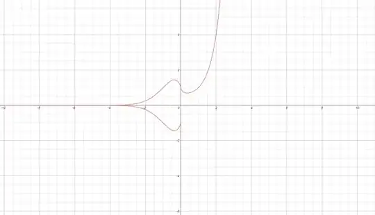

A more direct answer is the reason your graphing calculator doesn't graph when $x<0$ is because there are infinite undefined "holes" and infinite defined points in the real plane. Even when you restrict the domain to $[-2,-1]$ this will still be the case.
Note that for $x^x$ when $x<0$ if you calculate for the output of certain x-values (using the Texas I-85) you will have...
$$x^x=\begin{cases} (-x)^x & x=\left\{ {2n\over 2m+1}\ |\ n, m \in \Bbb Z\right\}\frac{\text{even integer}}{\text{odd integer}}\\ -(-x)^{x} & x=\left\{ {2n+1\over 2m+1}\ |\ n, m \in \Bbb Z\right\}\frac{\text{odd integer}}{\text{odd integer}}\ \\ \text{undefined} & x=\left\{ {2n+1\over 2m}\ |\ n, m \in \Bbb Z\right\}\bigcup \left\{\mathbb{R}\setminus{\mathbb{Q}}\right\} \left(\frac{\text{odd integer}}{\text{even integer}},\text{irrational numbers}\right) \end{cases}$$
(Just remember to simplify fractions all the way until the denominator is a prime number (ex: $2/6\to1/3$))
This is because when we have $x^a$ it can only extend to the negative domain if $a$'s denominator is odd (ex: $x^{1/3},x^{2/3}$).
Thus there are infinite undefined values from $[-2,-1]$ that are still (even/odd) when simplified. For example $( -3/2,-1/2)$ are undefined but so is $ (-19/10, -17/10, -15/10...-11/10)$ and $(-199/100, -197/100, -195/100,.....-101/100)$. This includes irrational numbers.
There is also infinite defined values. There are infinite defined values that have positive output and infinite defined values that have a negative output. For example there is $(-2,-4/3$), ($-2,-24/13,-22/13,-16/13...-14/13)$ and $(-2,-52/27,-50/27,-48/27,-46/27,-44/27...-28/27)$ that are still positive.
Then there is $(-5/3,-3/3)$, $(-25/13,-23/13,-21/13,-19/13..-13/13)$ and $(-53/27,-51/27,-49/27,-47/27,-45/27,-43/27...-27/27)$ that is negative.
Because the function is so "disconnected" with undefined holes and real numbers the graphing calculator still fails to register a graph of $x^x$ when $x<0$.
Thus when you see $x^x$ with the three graphs in the peicewise definition note that I am hiding the infinite holes that exist for ${x}^{x}$.
Now since the outputs for the negative domain can be positive or negative we have two "trajectories". Thus we must graph $\left(-x\right)^{x}$ and $-\left(-x\right)^{x}$ with $x^x$. x^x: The complete graph
However, if you want to graph $x^x$ to seem "more continuous" you can either $|x|^{x}$ or $\text{sgn}{\left(x\right)}|x|^{x}$.
