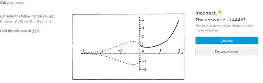

The question is to find the infimum of $$f(x)=x^x$$
This is the question I tried and I obtain the answer as $e^{-\frac1e}$ but I don't understand why did he define the function as $f\colon\mathbb R\to\mathbb R$ when $\color{blue}{\text{the domain of this function is}}$ $x>0$. I don't understand $\color{red}{\text{how it can be negative?}}$
Maybe I don't know the meaning of infimum or the greatest lower bound. I know it is different from minimum of function but in this case I don't understand. Please help !

    It looks like the pictured answer is allowing $x^x$ to be defined for negative values of $x$ that are rational numbers with an odd denominator (hence the dotted lines to the left, with positive values for even numerators and negative values for odd numerators). – Barry Cipra May 24 '21 at 17:05

    $f$ is not $\mathbb R \to \mathbb R$, since $f(x)$ is not real for most negative $x$, so this is a bad question. That then leads to trying to interpret the graph to work out what was actually intended. – Henry May 24 '21 at 17:12

$f$ is not $\mathbb R \to \mathbb R$, since $f(x)$ is not real for most negative $x$, so this is a bad question. That then leads you to trying to interpret the graph to work out what was actually intended.
Visually, the lowest point on the graph seems to be near $x=-\frac13$
If you try to interpret $\left(-\frac13\right)^{-1/3}$ as the reciprocal of the real cube root of $-\frac13$ then you get $f\left(-\frac13\right) = -{3}^{1/3} \approx -1.44225$.
Can you do better? Other values which might behave similarly include those of the form $-\frac ab$ where $a$ and $b$ are positive odd integers and $f\left(-\frac ab\right)= -\left(\frac ba\right)^{a/b}$. You need $b$ to be odd to give a real root and $a$ to be odd to give a negative result.
To make this as small as possible, you want to make $-y^{-y}=-\left(\frac1{y}\right)^y$ as negative as possible with $y$ positive and of suitable form $\frac ab$ where $a$ and $b$ are positive odd integers. Unconstrained on the positive reals that would be minimised by $y={e^{-1}}$ giving $-e^{e^{-1}}$. That $y$ is not of suitable form but it can be approached arbitrarily closely by rationals of the correct form and so $-e^{e^{-1}} \approx -1.444668$ is the desired answer.
For example $\frac{18089}{49171}$ is close to $e^{-1}$ and this would give $f\left(-\frac{18089}{49171}\right) = - \left(\frac{49171}{18089}\right) ^{18089/49171} \approx -1.444668$, which is extremely close to this infimum.

Okay this is a "machine generated" problem. And I don't think it is useful or fair question.
Grown up humans define $x^y$ as requiring that $x > 0$ and $x^y$ be defined for real (possibly irrational $y$) via the calculus definition[1].
Children humans define $x^y$ as requiring that $y$ be an integer and $x$ can be anything and $x^y = \underbrace{x*x*x*....*x}_{y\text{ times}}$.
And adolescent humans define $x^y$ as $y$ being a rational number written and $y=\frac mn$ in lowest terms ($n> 0$ but $m$ may be any integer) and $x^{\frac mn} =\sqrt[n]{x^m}$. $x$ can be any positive real but if $x< 0$ then we must have $n$ is odd and $x^y$ will flip from positive to negative whether $m$ is odd or even.
The adolescent human definition is rather naive and fairly useless and leads to confusion and problems. So "real" mathematicians use the grown-up human definition.
... But this "machine" used a combination of the adolescent human and the grown up human to have $x^x$ be the calculus real definition if $x > 0$, but if $x < 0$ then the adolescent domain only consists of rational numbers with odd denominators.
Now you are correct. For $f:\mathbb R^+ \to \mathbb R; f(x) = x^y$ the $\inf f(x) = e^{-\frac 1e}$ (when $x = \frac 1e$ then $f(x) =(\frac 1e)^{\frac 1e} = e^{-\frac 1e}$).
But if we allow negative rational with odd denominator values of $x$ into the domain as though we were adolescents then we can't have $\inf f(x) \ge 0$ because negative outputs do exist. SO the machine points at the $\inf f(x)$ if we allow negative values then the $\inf f(x) \approx -1.44467$. (This is $-e^{\frac 1e}$ by the way... and yes the value does not actually exist as the only negative values that do exist are the rationals with odd denominatiors-- but the $\inf f$ is a bound which need not be met... but... well, read the next paragraph....)

It is possible to define $x^y$ even if $x$ is negative. This doesn't even require complex numbers. The function $x^2$ is perfectly well-defined even when $x<0$. In general, if $y$ is rational number $a/b$, where $b$ is odd, and $a$ and $b$ are coprime, then $$ x^y = \left(\sqrt[b]{x}\right)^a \, . $$ Note that $\sqrt[b]{x}=-\sqrt[b]{-x}$, and so $$ x^y= \left(-\sqrt[b]{-x}\right)^a=(-1)^a(\sqrt[b]{-x})^a=(-1)^a(-x)^y $$ In the case of $x=y$, this becomes $$ x^x=(-1)^a(-x)^x \, . $$ To find the infimum of $x^x$, we can restrict our attention to the case where $a$ is odd. This corresponds to the lower part of the dotted line on the graph. This is when $x^x=-(-x)^x$.
Consider the function $g(x)=-(-x)^x$. Using the fact that $g(x)=-\exp(x\log(-x))$ for $x<0$, we find $$ g'(x)=-e^{x\log(-x)}(\log(-x)+1) \, . $$ The minimum of $g$ occurs when $x=-1/e$, but notice that $x^x$ isn't even defined for this value. However, we can find values of $x$ which are arbitrarily close to $-1/e$ for which $x^x$ is defined. Hence, the infimum of $x^x$ is $$ -\left(\frac{1}{e}\right)^{-1/e} \approx -1.44 \, . $$
