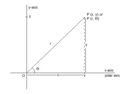

For starters, we need to look at the set of complex numbers. We can write complex numbers as $x+yi$, but they can also be represented in what is called polar form, as an angle and a magnitude.
polar
Accept the following: When we multiply two complex numbers together, we multiply their magnitudes (not as important for this topic) and add their angles (very important). For example, the complex numbers at $(1, 30^\circ)$ and $(1, 40^\circ)$ will have a product located at $(1, 70^\circ)$.
Whenever you take a square root of a complex number, realize that there are two complex numbers you can square that will get you to that number. If the original complex number has an angle of $20^\circ$, the root could either be $10^\circ$ or $190^\circ$, because $190^\circ \cdot 2 = 380^\circ = 20^\circ$. You can see why the second angle solution is tricky, and so that's why we consider the $10^\circ$ solution the principal root, even though the other one can be squared to get the same value.
This is why the positive reals (with angle $0^\circ$) can have square roots of $0^\circ$ (the positive root), and $180^\circ$ (the negative root), and why we consider the positive root the principal one.
