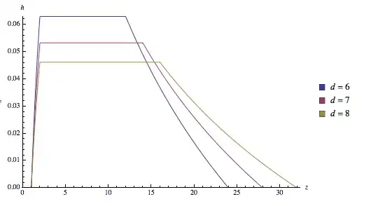

Here is a plot of the pdf for Case 1:
PlotDensity[h /. {a -> 2, b -> 4, c -> 1/2, d -> {6, 7, 8}}]

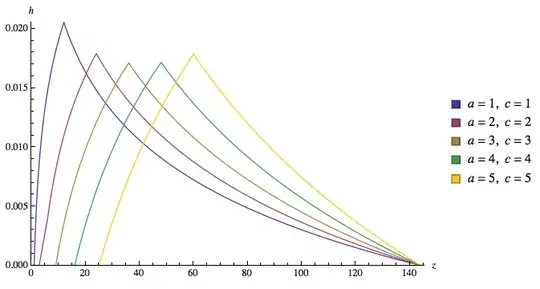

Here is a plot of the pdf for Case 3, for your set-up, with $a = c$, and $b = d$:
PlotDensity[h /. {a -> Range[5], b -> 12, c -> Range[5], d -> 12}]

  • In case 2, of course, we can simply make a change of variables and use case one, as they're symmetric. At the moment, I have two specific cases, both with a>0, c>0, one of which falls into case 1, but the other falls into case 3, as a=c, b=d. I'd also really like to have the probability density function Pz(a,b,c,d) if possible, as I don't have access to Mathematica, and there are a lot of different ranges of z that are significant for this problem, more than I could ask someone to solve for me. – Theodore Murdock Apr 29 '13 at 14:54
  • @TheodoreMurdock Hi Theo - yes, case 2 by symmetry, and case 3 can be obtained as a special case of case 1 or 2. I've updated the above to include case 3 + plot. – wolfies Apr 29 '13 at 15:39
  • Oh...sorry for being slow to get it, I just realized your function h is the probability density I need, taking different forms in different regions of the graph. Thanks for the help! Now I just need to plug in the numbers, integrate over the proper interval, and I'll be able to clear up the confusion I started a few years ago over how many dwarves are fat enough and tall enough to wield a two-handed sword in dwarf fortress. – Theodore Murdock Apr 29 '13 at 15:52
