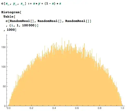

Let $X$, $Y$ and $Z$ be random variables with probability distributions $f_X, f_Y, f_Z$ taking values in the unit interval $[0,1]$. I'm interested in the distribution of $$X\cdot Y + (1-X)\cdot Z,$$ which always again takes values in $[0,1]$.
Below we see a histogram of samples for $X,Y,Z$ uniformly distributed (and it reminds me of some Shannon entropy function).

$$\eqalign{E(f(XY+(1-X)Z))&=\int_0^1\int_0^1\int_0^1f(xy+(1-x)z)dxdydz= \int_0^1\int_0^1\frac{1}{y-z}\int_z^yf(t)dtdydz\cr &=2 \int_{y=0}^1\int_{z=0}^y\frac{1}{y-z}\int_z^yf(t)dtdydz\cr &=2 \int_{t=0}^1f(t)\int_{z=0}^t\int_{y=t}^1\frac{dy}{y-z}dydzdt\cr &=2 \int_{t=0}^1f(t)\int_{z=0}^t\big(\ln(1-z)-\ln(t-z)\big)dzdt\cr &=2 \int_{t=0}^1f(t)\Big[-(1-z)\ln(1-z)+(t-z)\ln(t-z)\Big]_{z=0}^{z=t}dt\cr &=2 \int_{t=0}^1f(t)\big(-(1-t)\ln(1-t)-t\ln(t)\big)dt\cr &=2 \int_{t=0}^1f(t)\ln\frac{1}{(1-t)^{1-t}t^t}dt\cr }$$ So, the desity function of $T=XY+(1-X)Z$ is $$f_T(t)=2\textbf{1}_{(0,1)}(t)\ln((1-t)^{t-1}t^{-t}).$$ A plot of this density function can be found here.
