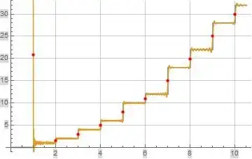

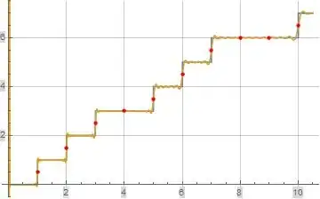

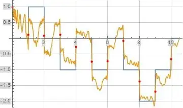

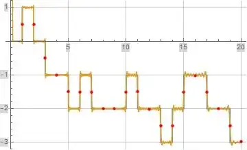

The four explicit formulas defined in (5) to (8) above are illustrated in the following four plots in orange and the corresponding reference functions defined in (1) to (4) above are illustrated in blue. All plots are evaluated over the first 200 pairs of zeta zeros and the sum over $n$ is also evaluated with the upper limit $N=200$. The red discrete portions of the plots illustrate the evaluations of the explicit formulas at integer values of $x$.
Illustration of $Q_o(x)$
$\text{Figure (1): Illustration of $Q_o(x)$}$
Illustration of $M_o(x)$
$\text{Figure (2): Illustration of $M_o(x)$}$
Illustration of $\Phi_o(x)$
$\text{Figure (3): Illustration of $\Phi_o(x)$}$
Illustration of $L_o(x)$
$\text{Figure (4): Illustration of $L_o(x)$}$
I initially thought perhaps the formula for $\Phi_o(x)$ was wrong as it seemed to exhibit a different convergence than the the formulas for $Q_o(x)$ and $M_o(x)$ which was the motivation for my earlier question, but I subsequently noticed the formulas for $Q_o(x)$ and $M_o(x)$ also seem to exhibit slightly different convergences. Note $Q_o(x)$, $M_o(x)$, and $\Phi_o(x)$ illustrated in figures (1), (2), and (3) above seem to converge for $x>b$, $x>c$, and $x>1$ respectively where $0<b<c<1$. I'm now trying to understand why explicit formulas such as $Q_o(x)$, $M_o(x)$, and $\Phi_o(x)$ seem to exhibit different lower convergence bounds.
Question (1): Is there a simple explanation as to what determines the lower convergence bound with respect to $x$ of explicit formulas such as $Q_o(x)$, $M_o(x)$, and $\Phi_o(x)$?

Note the explicit formula $L_o(x)$ illustrated in Figure (4) above doesn't seem to converge.
Question (3): Is the explicit formula $L_o(x)$ defined in (8) above incorrect and if so, what is the correct explicit formula for $L(x)$?

  • The explicit formula for $\sum_{n \leq x} \varphi(x)$ is wrong; when you shift the contour, the shifted contour integral is not small. One can use this to show that the error term for this sum is at least as large as a constant multiple of $x\sqrt{\log \log x}$ infinitely often. – Peter Humphries Apr 17 '18 at 10:08
  • @PeterHumphries Is the error in $\phi_o(x)$ related to the large growth of $\phi(x)$ which is proportional to $x^2$? – Steven Clark Apr 17 '18 at 16:20
  • I don't understand the question. What I mean is that $\sum_{n \leq x} \varphi(x)$ has a main term, coming from the pole of $\zeta(s - 1)/\zeta(s)$ at $s = 2$, and an error term of size at least $x\sqrt{\log \log x}$, which does not come from the poles of $\zeta(s - 1)/\zeta(s)$ at the zeroes of $\zeta(s)$. – Peter Humphries Apr 17 '18 at 17:02
  • Also, your explicit expression for $L(x)$ should involve additional terms; see "The Explicit Formula for $L_0(x)$" by A. Y. Fawaz. – Peter Humphries Apr 17 '18 at 17:02
