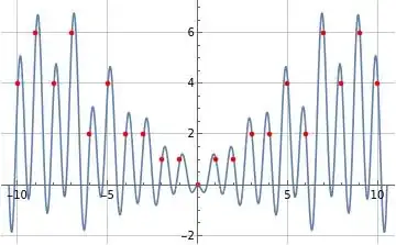

The following figure illustrates formula (10) for $\tilde{a}(s)$ corresponding to $a(n)=\varphi(n)$ where formula (10) is evaluated at $K=20$ and $f=1$. The red discrete portion of the plot represents the evaluation of $\varphi(|s|)$ at integer values of $s$. Note formula (10) for $\tilde{a}(s)$ converges to $0$ at $s=0$ and to $a(|s|)$ at positive and negative integer values of $s$.
Illustration of formula (10)
Figure (1): Illustration of formula (10) for $\tilde{a}(s)$ corresponding to $a(n)=\varphi(n)$
