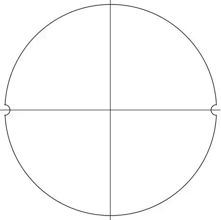

where $C$ is the following contour:
i.e., the circle $|z|=1$ with semicircular notches of radius $\epsilon$ cut into the circle at the poles $z=\pm 1$. By Cauchy's theorem, this integral is zero. However, we can use this fact to deduce a nontrivial integral.

Note that the point at which I started and ended the integration on the circle is arbitrary; I chose it so that I was able to encompass the small semicircles in their entirety rather than split them up. Now take the limit as $\epsilon \to 0$, and I can simply express the Cauchy principal value over the circle over any interval of length $2 \pi$. By Cauchy's theorem, we have
