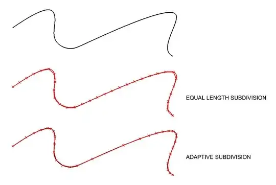

I've been researching into this for quite a while, but I seem to be getting only answers involving some programming language of which I do not have any background knowledge. Let me explain the problem:
I think "equal length subdivision" of the image should be a straightforward visualization of the problem. I have a curve (a parametric Bezier curve, to be more specific) that I want to divide such that any two consecutive points of division have equal Euclidean distances between each other. The first and the last chords have to be on the beginning and the end of the curve respectively, and all points of division should be on the curve.
Ideally I would like to have a mathematical solution (i.e. no programming) in which I can specify the number of chords to obtain the resulting division points. I am perfectly fine with calculus and ready to learn more if needed.

    My current answer assumes that you measure distance along the curve. Is this wrong? What do you mean exactly by distance of consectuive points? The usual euclidean distance? – M. Winter May 23 '17 at 10:11
  • Yes, I was referring to the usual euclidean distance, the shortest distance between two points. Sorry it seems to have been ambiguous. – CrazyRabbitKGe May 23 '17 at 10:23
    @CrazyRabbit: As M. Winter says, you need to say whether distance is measured along the curve (arc length) or in the ambient space (chord length). In either case, an analytic solution is impossible: Even if your curve is cubic Bezier, the arc length integral is not generally elementary, and cannot be expressed "in closed form", much less inverted to obtain an equal-length subdivision. On the other hand, subdividing a curve segment into equal-length chords is a global problem, arguably worse than equal-length curve segments. – Andrew D. Hwang May 23 '17 at 10:27
    I see, that seems to be the reason why almost all discussions involved program-generated algorithms. I guess I should attempt more roundabout ways of tackling it. Thanks! – CrazyRabbitKGe May 23 '17 at 10:35
