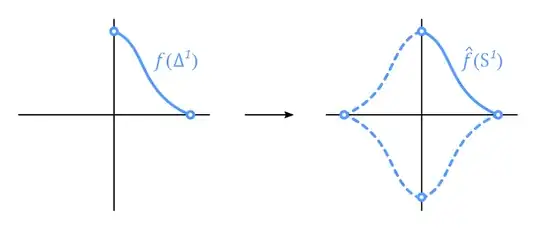

Maybe you could use the generalized Jordan curve theorem for $S^n$ to prove this.
Given an embedding $f$ of the $n$-dimensional sphere $S^n$ into $\Bbb R^{n+1}$, then the space $$\Bbb R^{n+1}\setminus f[S^n]$$ obtained by cutting out this embedding from the ambient space will leave exactly two connected components, one bounded and one unbounded.
My idea is that your embedding $f$ of the simplex into $\Bbb R^{n+1}$ can be extended to an embedding $\hat f$ of $S^n$ by mirroring the embedded simplex on all the coordinate (hyper-)planes.

Now assume there is a ray starting in $(0,0)$ going to infinity and not intersecting the simplex $f(\Delta^n)$. This ray also will not intersect the sphere $\hat f(S^n)$ because it only lies in the single positive orthant $\Bbb R^n_+$. Because it starts in $(0,0)$ it belongs to the bounded component of the sphere (proof?). But obviously the ray is undbounded. Contradiction!
You see that this is just a rough sketch. When I have more time I may formalize it sufficiently. I think the advantage of this informal proof is that it externalizes the heavy homotopy/homology theory to the proof of the generalized Jordan curve theorem.
M. Winter
  • 30,828
  • A very nice idea! Unfortunately $f$ is not necessarily an embedding because it may have self-intersections :( Is there a theorem for immersions stating that the complement must have exactly one unbounded component? –  May 25 '17 at 22:42
  • @Rahul Right! I forgot about the non-injectivity of $f$. And back to the sketch block. – M. Winter May 25 '17 at 22:44
