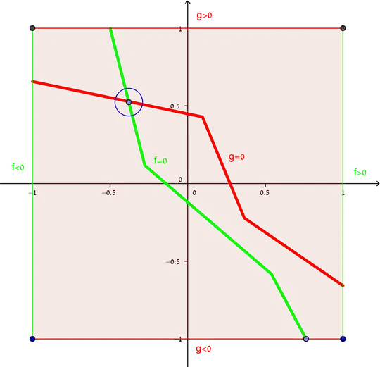

My current "proof" is graphic:
I.e., by the condition on $f$ (green), there must be a connected "wall" (green), separating the west side from the east side, in which $f=0$. Otherwise we could go from $f<0$ to $f>0$ without passing through $f=0$, which is impossible.
Similarly, by the condition on $g$ (red), there must be a connected "wall" separating the north side from the south side, in which $g=0$.
These walls must have an intersection point in which both functions are 0.

It is true but non-trivial and your idea cannot be formalized because the set of points at which $f$ is zero do not at all have to look like what you drew. They could for example be some weird set that looks like blotches, which may even be disconnected or fractal or both.
To prove it, use the 2d Intermediate value theorem, where $f,g$ are the two components of the continuous function from the square to $\mathbb{R}^2$. It is easy to check that that function on the square's boundary winds around $(0,0)$ and hence we are done.
