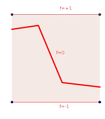

Let $f$ be a continuous real function defined on the unit square $[0,1]\times[0,1]$, such that $f(x,0)=-1$ and $f(x,1)=1$.
If we walk from $y=0$ to $y=1$ on any path, we must cross some point where $f=0$. Intuitively, there is a connected "wall" (a curve) that separates $y=0$ from $y=1$, on which $f=0$, like this:
My question is: is there a theorem that formalizes this intuition (if it is correct)? In particular: is there a theorem which implies that there exists a connected line that goes from $x=0$ to $x=1$, on which $f=0$, as in the picture?

  • First of all, if $f$ is not injective, there may be more than place $f=0$ for a given $x$. For example, $f(x,y)=cos(3\pi y)$. – ET93 May 14 '15 at 02:45
  • @ET93 OK, but does there always exists a connected path from $x=0$ to $x=1$ on which $f=0$? – Erel Segal-Halevi May 14 '15 at 03:02
  • This is more related to the implicit function theorem than the IVT. If you assume the conditions of the IFT, you can get a differentiable function from some open set of $[0,1]$ to the points where $f=0$. – ET93 May 14 '15 at 03:36

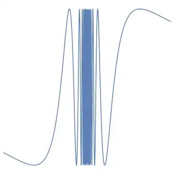

    You shouldn't say "connected line" because the connected set you want may well be like the topologist's sine curve at the left and right sides of the square, so there is no notion of line that would capture what you want. Instead you could say "connected set containing at least one point on each of the left and right sides of the square". – user21820 May 15 '15 at 05:37

Now your question (if I'm interpreting it correctly) is whether the zero level set contains some continuous curve. I don't think this is necessarily the case. Consider for instance the set $S$ given by two copies of the topologist's sine curve: $$S = \left\{ \left( x,\frac{1}{2}+\frac{1}{2}\sin\frac{1}{2x-1}\right)\ \Big\vert\ x \neq \frac{1}{2}\right\} \cup \left\{\left(\frac{1}{2},y\right)\ \Big\vert\ 0 \leq y \leq 1\right\}.$$
$S$ is closed and so the distance function $d(x,y)$ of $(x,y)$ to $S$ is well-defined and continuous. Also define a sign function $\epsilon(x,y)$ to be 1 above and -1 below the sine curve, i.e.
$$\epsilon(x,y) = \begin{cases}\textrm{sign}\left(y-\frac{1}{2}-\frac{1}{2}\sin\frac{1}{2x-1}\right), &x\neq \frac{1}{2}\\0, & x = \frac{1}{2}\end{cases}$$ and set $f=\epsilon d$ to get a counterexample where $f^{-1}(0)$ is not path-connected.
(This $f$ does not exactly satisfy your boundary conditions at $y=\pm 1$, but this could be fixed by e.g. taking $f(x,y) = (\epsilon d)(x,[4y-1]/2)$ on $y\in (1/4,3/4)$ and extending appropriately.)

    OK, but how does this prove that there exists a connected path from $x=0$ to $x=1$ on which $f=0$? – Erel Segal-Halevi May 14 '15 at 03:03
  • @ErelSegal-Halevi I've edited my answer. – user7530 May 14 '15 at 04:21
  • I think I see what you mean: $f$ changes continuously from being negative below the sine to being positive above the sine; it is 0 only on the sine, which is not path-connected. But, the sine is connected, so this still isn't a counter-example for my question. – Erel Segal-Halevi May 14 '15 at 04:58
  • Then you need to state, very precisely, what you mean in your question. There is not "continuous 'wall' (a curve) that separates y=0 from y=1, on which f=0" in the example above. – user7530 May 14 '15 at 04:59
  • You are right; I fixed the question to say "connected". – Erel Segal-Halevi May 14 '15 at 05:00
    @ErelSegal-Halevi I think what you want to ask is, "does $f^{-1}(0)$ have a connected component that includes a point on both $x=0$ and $x=1$." The revised question still asks for a "curve" which does not exist in the example above. – user7530 May 14 '15 at 05:07
    Yes, I meant to ask about a connected component. Does the word "curve" implies path-connectedness? – Erel Segal-Halevi May 14 '15 at 05:22
    Of course the precise definition is convention dependent but at minimum a curve is a continuous map of a real interval. – user7530 May 14 '15 at 05:42
