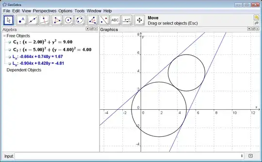

Here are the results plotted in GeoGebra for validation.
Screen
