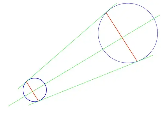

EDIT:
My problem is represented in this image (che 2D equivalent one).
I need to find red segments, that in the 3D space problem are circles. In order to find these I need to know (always in 3D) the center and the radius of red shapes, that always in 3D are conical frustum bases.
Jepessen
  • 298
  • There are many frusta tangent to both spheres (a quick mental exercise suggests four degrees of freedom). Are there any additional conditions you want to impose? – Travis Willse Oct 31 '14 at 16:16
  • I've edited the problem. Pleas check it. – Jepessen Oct 31 '14 at 16:34
  • This is a variation on the problem of finding the common (external) tangents to two circles; you might be able to adapt the solution given here: http://math.stackexchange.com/questions/211538/common-tangent-to-two-circles – Travis Willse Oct 31 '14 at 17:15
